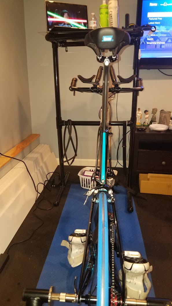

I did something similar with PVC and painted it black. I have to cut it down/lower it now that I have a true TT bike but it does the job. I have a clear piece of plexiglass as the base since I had it laying around. There’s enough of a gap between the plexiglass and the top rectangle to slide cords between them and it holds it well. Also the mid bar keeps it steady and lets me hang my HR monitor, spare tube, couple other things.
