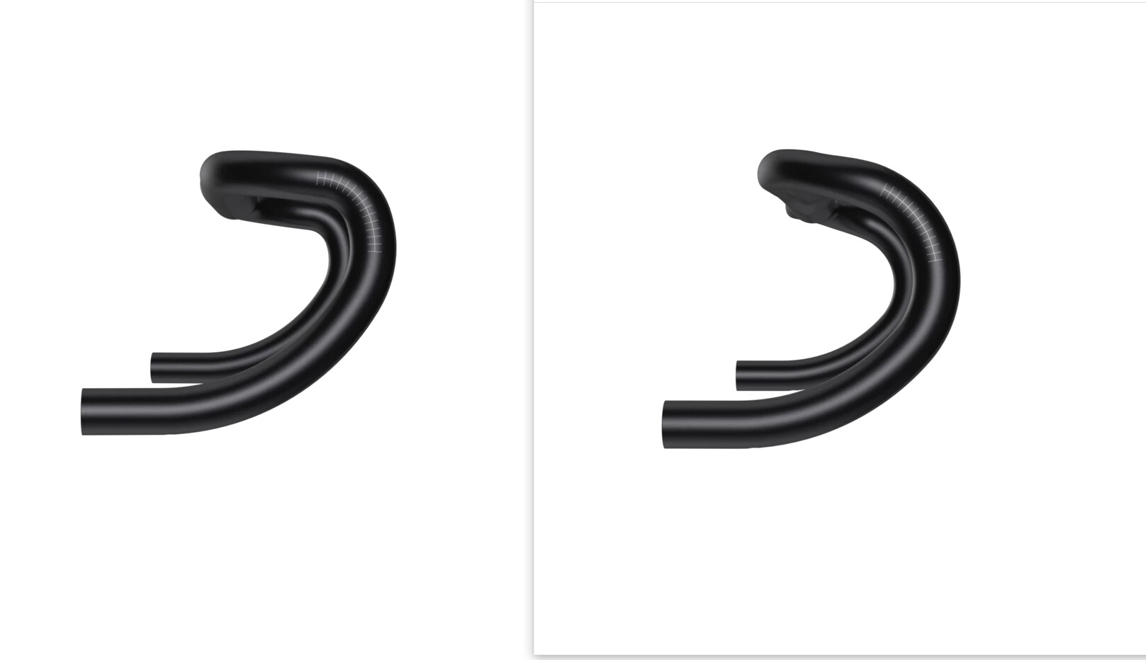

It’s pretty rare that changing the reach of the bar just changes the reach. The shape - and thus position of the hoods once they’re set up - almost always changes at least to some degree as well.
Here’s the Zipp SL-70 and SL-80. If you just want to push the reach out a bit, change the stem.

There’s little difference between the 70 and 80 other than the bend at the top. I like the bend on the 70 better.
I was thinking about this when I’ve looked at the bars side to side and I can’t figure out if I’ll like that sort of flatter section behind the hoods or not. I currently have the top of my shifter clamp at the top line on the 70 bars. When I’m out of the saddle I feel like the shifters are maybe too high as it bends my wrist awkwardly. I’ve wondered how the flatter section on the 80 would affect that.
