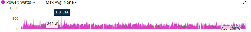

The figures we are using are pretty much my values - my most recent FTP done just last week at a 25m TT is 306w - so I will be working on the range of 215 - 230 say in upcoming long distance in a few weeks.
On my last long ride done two sundays back I came back with a AP of 209w / a NP of 225w for 112miles - so now happy my NP is well within the proper range - and felt reasonably good coming off the bike for my run after.
Looking at my power graph it looks decent (to the eye - pretty even with no major drop off) - I don’t use Trainingpeaks etc where I can take samples out etc and see my NP for sections - so not that detailed. But would imagine 2nd half would be slightly less than first, just going by the natural way most people would tend to go - but happy nonetheless with it.
This route had an ascent of about 3800ft as well so not completely flat - went on feel for the drags and tried never to red zone it.
Gary,
To my old eyeballs it appears that your power actually dropped off a good bit over the course of the ride. You were really spiking the high power times the first hour or so. Download a copy of Golden Cheetah. It’s free, highly featured and pretty darn intuitive to use. It will quickly show you things that aren’t easily apparent by eye.

Cheers Hugh- defo a drop off, but yeh maybe more than I like to think lol - didn’t look too bad to me - maybe I’m thinking cause it doesnt look like an elevation profile then its good :slight_smile:

The number of 500 watt episodes that occurred in the first hour or so is a huge red flag for overdoing. Notice that you didn’t do that very much later in the ride as PE probably came ore into line with reality. Vastly exceeding your FTP on a regular basis during an IM is not a recipe for a good run.
Now is certainly the time to sort this rather than after the IM.

I didn’t see if you mentioned HR. What did your HR do while the power was dropping on that ride? Have you heard of decoupling? Training Peaks (paid version) shows the Pw:HR.
Also, are you including zeros in your power data averaging?
Getting beyond my comfort zone :wink: whilst the terms do ring a bell (have read the Training/Racing with PM a while ago) - these are details i haven’t fully went into. I’m just using my Garmin default overview for my figures - so not analysing it to the extent of which it could be! It does interest me alot, just haven’t got into the real fine analysis of things just as yet in my training and racing! :slight_smile:
But looking at HR graph - yeh defo 2nd half there is a def increase - it was a rainy/windy day and I think it got a bit headwindy 2nd half which may account for parts of that.
