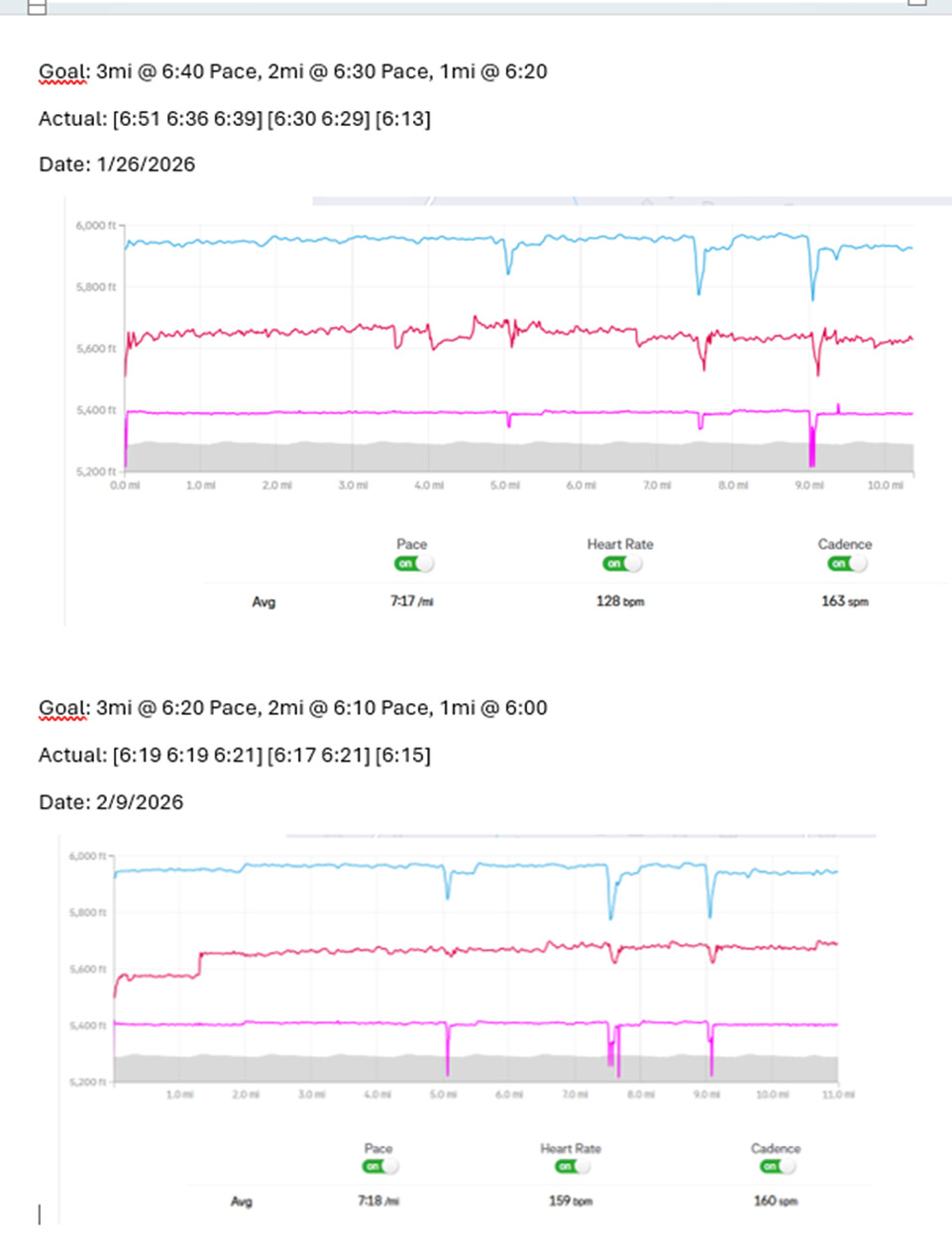

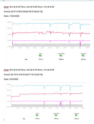

One thing that is actually kind of fun is to take a screen shot of your most recent workouts, paste it into chatgpt and tell it your goals etc and see the feedback it gives.
Today’s work out and the workout posted in my previous post (they just happen to be the same thing at progressing intensities)
Here is what Chat GPT says.
- These workouts are faster than MP and function like long tempo / marathon-strength workouts, which is exactly what they should be 14 weeks out.
  • Workout #1: First mile a touch slow (likely settling in), but you locked in perfectly after that. You closed faster than target on the final mile. Effort stayed controlled—no visible late fade or panic surge. This is “Comfortably hard, but sustainable which is exactly what you want at this stage.
  • Workout #2: Extremely even pacing—that’s a big upgrade. You did not force the final mile to 6:00, and that’s actually a good sign, not a bad one. Cadence stays consistent; no late-form breakdown. This is “strong aerobic control, with discipline” which is marathon fitness behavior, not 5K fitness behavior.
- You are clearly improving. Here’s why: In January, you overachieved late. In February, you held form without forcing. That suggests your threshold is rising, and MP is becoming more automatic.
- These training paces are appropriate with one importance nuance.
  • 6:20–6:10 = strong tempo / sub-threshold
  • 6:00 = flirting with threshold
At 14 weeks out, this is appropriate and productive and not premature as long as it’s not every week.
You are clearly not “hanging on” at these paces. You are exactly where you want to be at 14 weeks out - not ahead of schedule in a risky way, but ahead in execution quality.
Going forward keep marathon pace smooth, repeatable, and almost restrained. Instead of fasters paces extend time at marathon pace adding 6-10 miles late in long runs. Do not go faster in these segments just because it feels good. Keep it honest and boring.
Keep doing these descending pace works every 2-3 weeks, but not every week, to sharpen fitness without draining the system.
In 6-8 weeks if Marathon pace feels mentally quite, HR stays stable late, and you are finishing long runs wanting more that is a green light to commit to the top of your goal marathon time.
***Yes, Chat GBT is fun. It is full of flattery telling you that your poor pacing is just “settling in” and missing your target pace at the end of the workout is a good thing because it shows “discipline”, etc. :slight_smile: I am happy with the way running is going. I haven’t been as consistent on the bike as I would like the past two weeks due to travel. That was going to be a big part of my training. I will do the best I can with this plan and hope that on Race day I am not death marching to salvage a sub 3:00 again.
But doesn’t all that positivity feel good? Your own personal cheerleader looking over your data and giving you reasons why you’re gonna hit your goals.
Tell it you got attacked by a lion on your run and are now missing a foot, but you still think you can make it and it will still cheer you on I bet!
