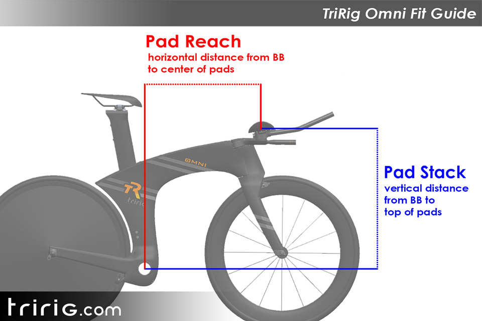

I’ve gone from a pad stack of 490mm to 515mm and feel better. I’m capable of going lower but I appear to be the same speed vs power as I had been before.
Hey Guys, just an observation from a metric Canadian, so other readers aren’t confused. 1cm = 10mm, not 100mm.
If your pad stack height is 500mm that’s over a foot and a half. Don’t try that at home.

**Pad stack and saddle to pad drop do not dictate your position… **or your aero drag. There is a huge amount of positional range based on how you hold your shoulders, neck, and head. I raised mine 80mm and it was better in every way. 45mm isn’t a lot.
