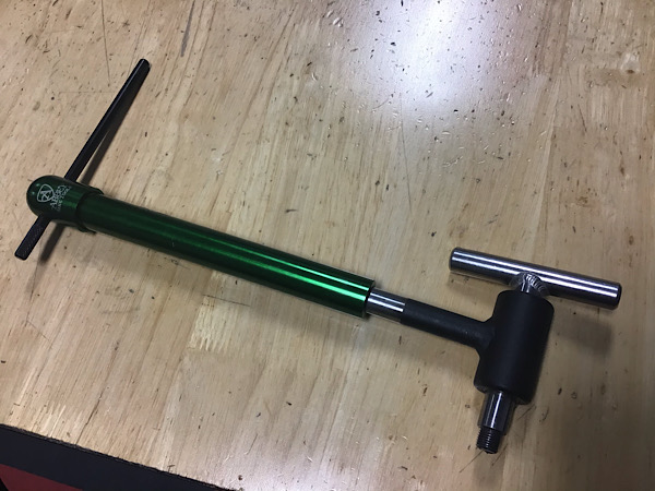

I just tried this budget one from Amazon. All the pieces are actually very well made, but there was just enough play between the arm and the piece that bolts to the hanger to give maybe 5mm of play at the far end of the arm, which for me made it pretty much useless. So I’d have to say go Park at a minimum.
I’m also a fan of the Abbey HAG.
Yeah, it’s amazing how small the tolerances have to be for this tool to work well. I think my adjustments have been <5mm every time , but really fixed up the small problems with shifting.
Next step up from Park.
Cry once, buy once, and live the rest of your life with the best tool for the job that money can buy.
Carbon parts aren’t that delicate.
I am a bicycle manufacturer. The frames and derailleur hangers are perfect when I ship them out or deliver them in person. If a customer crashes, I would expect that they would fix a derailleur hanger themself or bring it to a shop.
Ill second the Abbey HAG, especially with the finite range for the new 12spd stuff I feel it is a must have.
