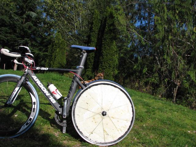

That title is from youtube, where a Deutsche? kid built an aero wheel. I thought that was pretty cool so with a orphan rear wheel I decided to build me a clincher disc. It’s kind of a Zipp - HED hybrid … Zipp uses a foam core, and HEDs are covers over the base Alu rim. This is both an alu rim and foam core.

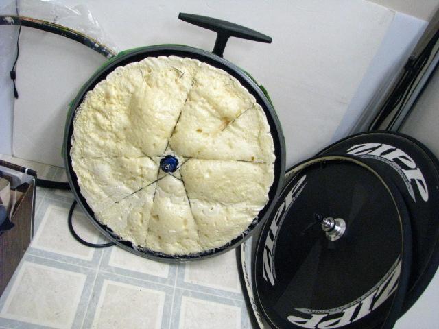

OK so step one was to prep the wheel and douse the inside area with PU foam to support the outer layer. I had my doubts with the foam application but it turned out promising. Today we shave the expanded foam and sand it smooth, and then decide what to do next. It would be possible to actually just use a xx mil adhesive vinyl if the foam is smooth enough. If not I have 2x2 twill I can use but that will impact weight and make the thing stiff as blazes.

Whomp whomp is good…and you know she drums like that already… stoked about the weight. After going at it with a watermelon knife, body file, and sander I tipped the scales at under 1100g.

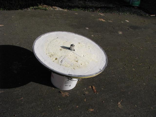

I drove into town on my way to get beer and smokes, looked for some sandable sheet “instulation”. Nothing suitable. I wanted a spreadable filler, super light. So I made a water-based mixture using some superlight West filler I had in the shop. Binder, fillers - hope it works! 24 hours to set up before sanding, which should be super easy to do. Why foam? As it expanded, the foam is very, very light. No real structure is necessary, just resistance to blowing out of the spokes. A foam core with a thin vinyl covering should be the lightest possible setup.

The PU foam was really nothing - under 100 grams. I made an error on the filler for fairing in.
This morning on my way to cigarettes and coffee, I got some lightweight spackle and also latex foam. Used some of the both to clean things up. It’s setting up right now.
