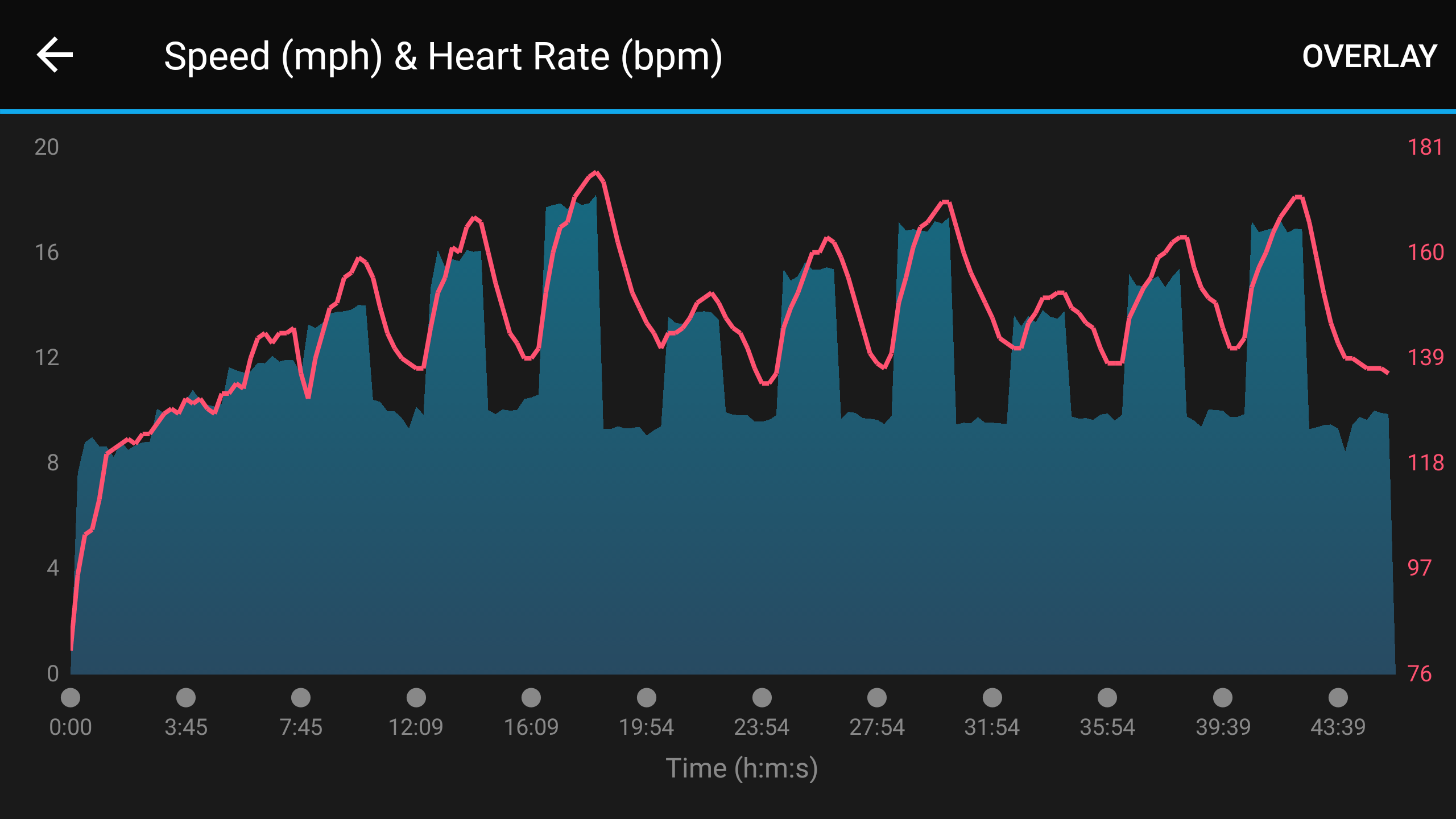

I keep looking into the Scosche but I was under the impression it was not advised to swim with it or submerge it for long periods of time? even DC rainmaker mentioned this in his review. has yours been fine how much do you swim with it? (I would only do it on race day)
I don’t swim with mine so I can’t comment on its swim longevity. It’s hard to swim with it on race day as well since it gets in the way of the wetsuit if you wear it under it, and you’ll be afraid it’ll fall off if you use a sleeveless. It’s the main negative I think of it.
I raced with mine (Scosche) at Choo 70.3. I don’t have any idea how many seconds it took me to put it on in T1 (I left it in my bike shoe), but it couldn’t be many (seconds).
You’d spend more time than that F’n with it over/under a wetsuit…or possibly adjusting it (sans wetsuit) …during your swim (where it is of zero value to you, anyway).
