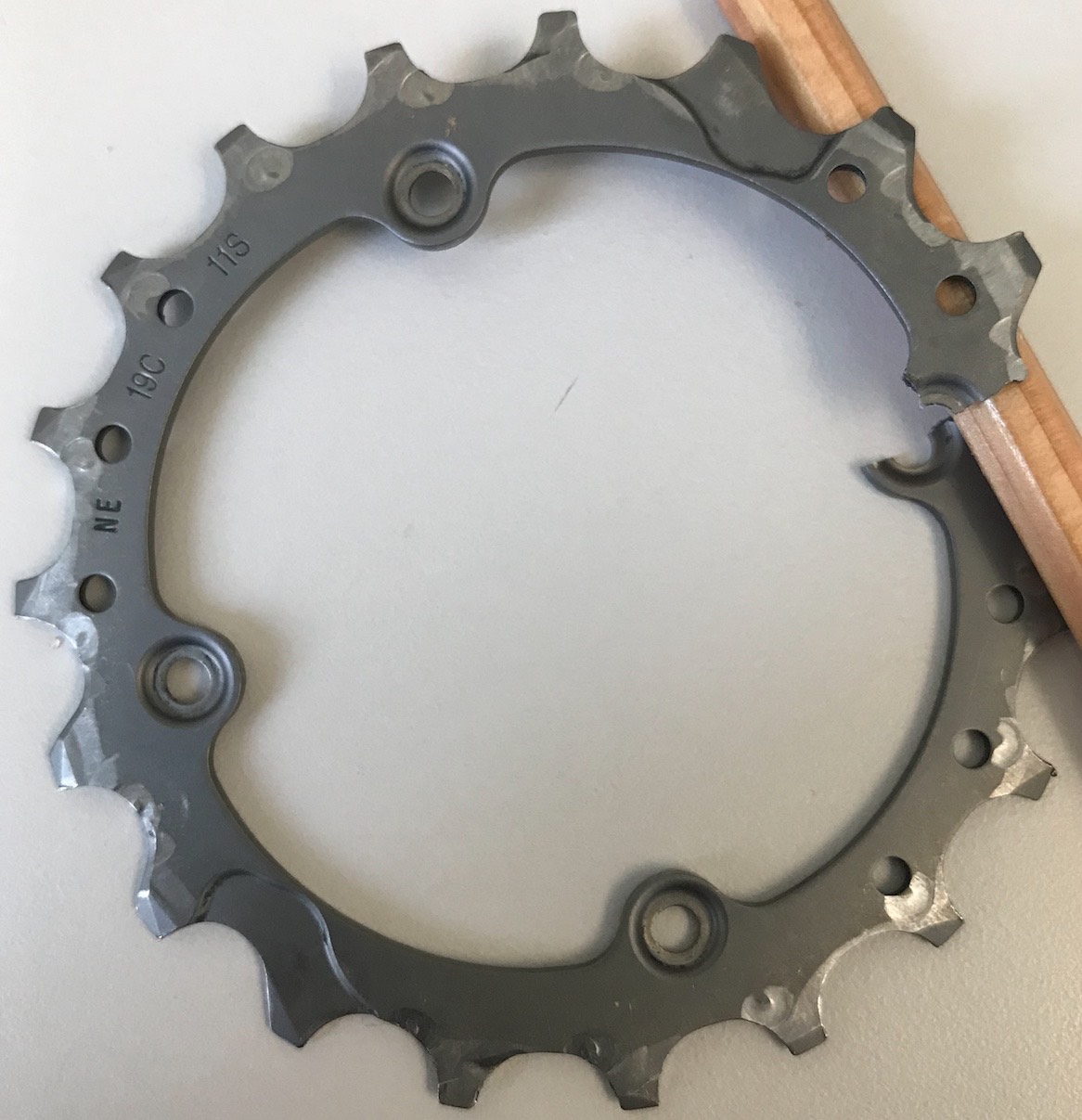

Just curious, as I’ve never heard of this happening to anyone. I was on an ~18% grade in the 19 tooth Dura Ace titanium cog, out of the saddle, giving it everything I’ve got (which isn’t much), when the cog ripped out entirely, broken clean through. Managed to not go down or otherwise hurt myself. About 9,000 miles on the drivetrain, 3 years old. Is this just excessive wear, a defective part, installation? FWIW, I weigh 165 pounds and I’d be surprised if my one-second power ever gets over 800 watts. I’ll admit to being a constant cross-chainer and sometimes I’ve used Wipperman chains and not Shimano, if any of that matters.
Early versions of the 11 speed durace had problems with the supporting spider breaking. I presume this is what happened here.
Shimano may warrant this, but really you got your normal miles out of it anyways.
The latest generations of DA cassettes do not have the best reputation - usually it’s the carbon carrier that breaks, though. I had one starting making squeaking noises in the largest cogs last year and changed it out knowing their history. I’d stick with Ultegra - or go SRAM Red if you want something fancy or their (IMO) better gear ratios.
Thanks for the useful comments… I ended up replacing it with an 11-28 Ultegra cassette.
Was it a DA 9000 cassette? As others have said, there are known issues with the carbon carriers creaking/breaking. Take a look at this article and see if your one is the same model:
https://bikerumor.com/2014/06/06/shimano-makes-running-change-to-dura-ace-9000-cassettes-to-eliminate-creaking/
I don’t know if Shimano openly acknowledge there is/was an issue now, but you might be lucky and get a warranty replacement.
Yes, that’s it… with the single rivet design as shown in the article.

Yup. Super common as said above. It’s basically a foregone conclusion on those models. Good news: send it to Shimano warranty replacement and they’ve seen so many of them that they’ll get you a replacement within a couple days.

This design suffered from the failure mentioned above, essentially the pins rub a little counterbore on the outer face of the titanium cog and over time a stress fracture develops that connects to the rivet, it’s as much a result of how narrow the spacing has become relative to the advancement in chains technology as anything else. Shimano have improved ‘fixed’ it in newer generations, but realistically 9000 miles from a Ti cassette is way beyond expectation… or at least way beyond traditional expectations.
