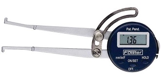

Using one of these would help:
Or one of these to provide the measured value directly:
Knowingly trying to TT with my rear wheel skewed or off-center would bug the crap out of me. Have you verified by measure? How’d did you accomplish the task? Thoughts?
