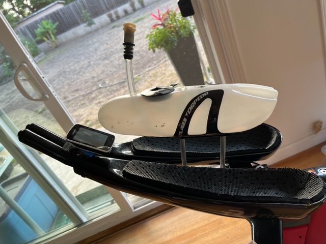

How to mount BTA above the arms on tririg Alpha One?
Anyone mount a water bottle BTA but above the arms
So maybe a ATA
Need it raised up approx 3”
Doesn’t fit between my arms
I used some of the longer screws and spacers from my Omega One brake kits, but it was only like an inch or so. I also need a bit more since I can’t move my pads any closer.
May just go to the hardware store and see what screws and washers they have to make it work.
Very clean look
How did you do that?
Aluminum rod and long M5 (not M6 as stated before) hex bolts. We have a local fastener store that carries everything here in San Diego. https://www.marshallshardware.com/
Cut rod to length with bolt long enough to get my arms under the sides of the bottle. Which worked nicely. However - Not using this configuration and bars anymore because I could not get my head down low enough.

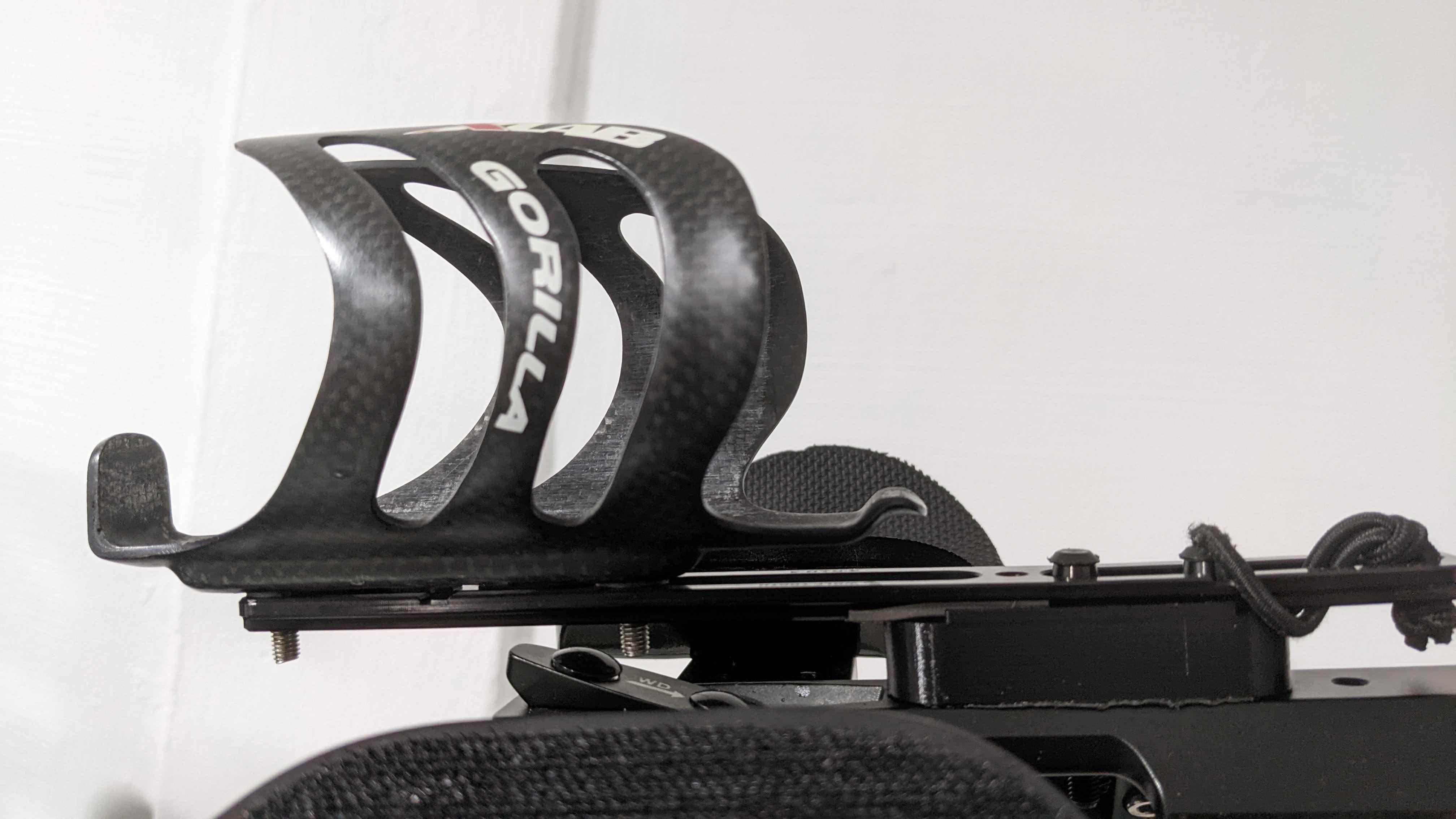

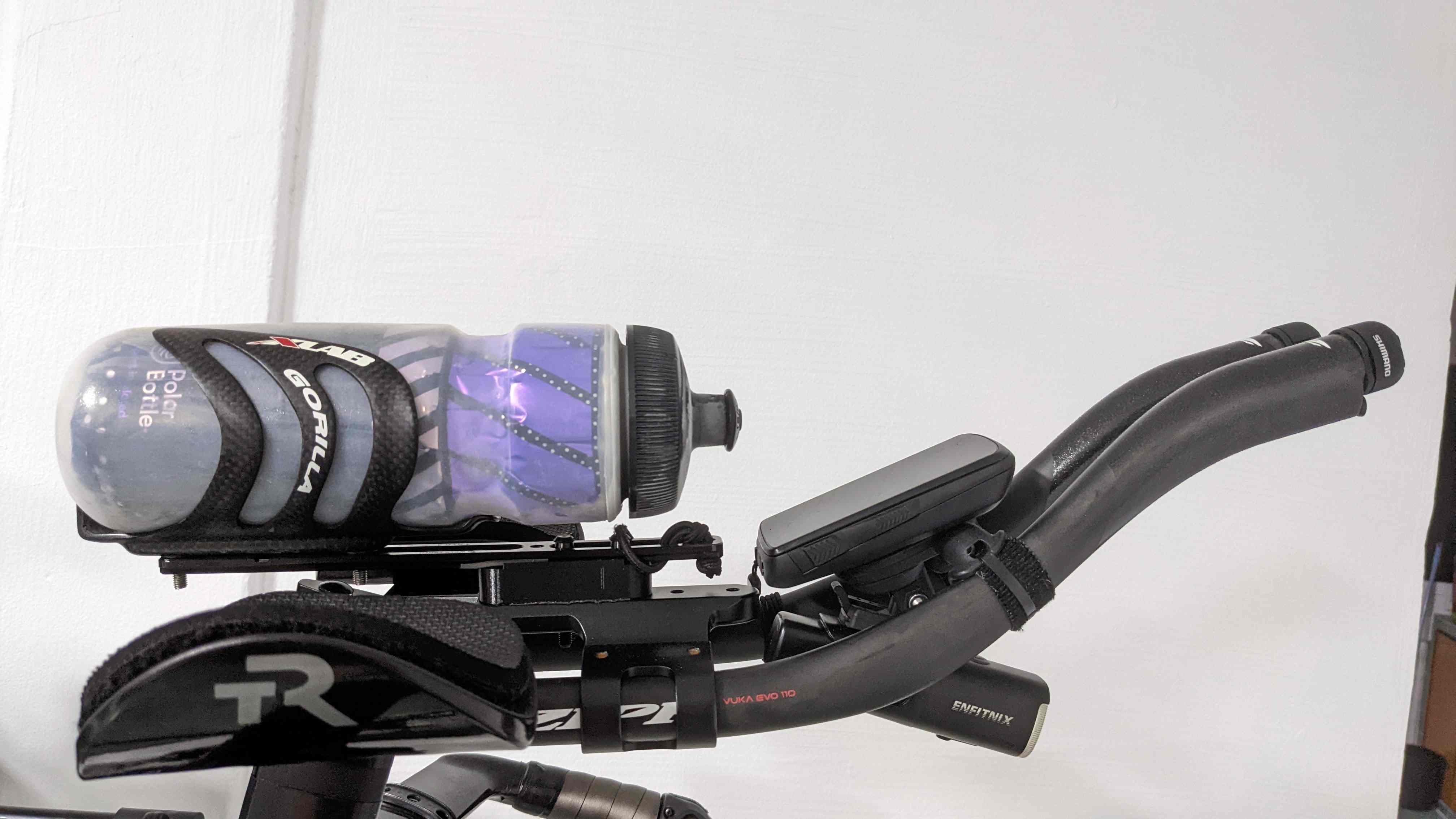

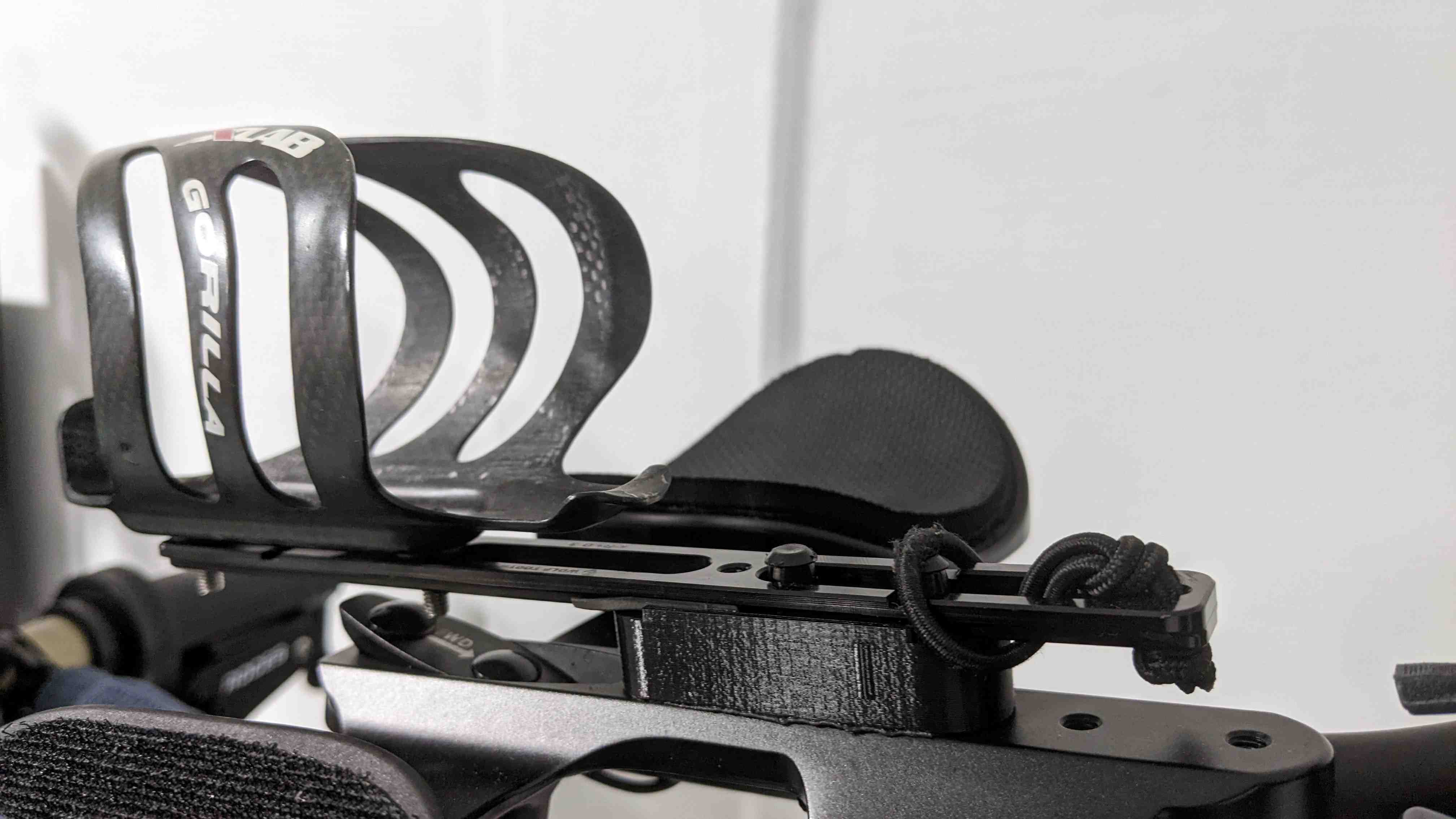

I have this to move mine further back.
Wolf Tooth B-Rad Mounting Bracket
I have a XLab Gorilla Cage mounted on a Wolftooh B-Rad which is than mounted with 3D printed spacer into the Trig Dragonfly.
This allows me to mount my bottles facing forward with enough clearance to my computer to take out and put back my bottles.
If you need the 3D printer file for the spacer, let me know, I can pass it over.
