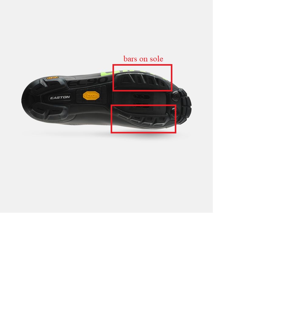

what ever you do, DO NOT put SPD MTB cleats on road shoes, this is a bad idea. The MTB cleats are meant to have the support of the side bars found on MTB shoes and are not designed for the flat sole of a road shoe and so they are not optimal and could lead to issues if you are looking at power and performance. But as said above, a really stiff MTB performance shoe should have similar lack of flex to a good road shoe. There are differences in the weight etc but again that is the sole and maybe at the high end of things they get closer together but a MTB shoe is typically heavier than the similar model in road.

The standard crank brothers egg-beaters don’t have any extra support from any bars.
the bars (made of rubber) are on the sole of the shoe not the cleats… one on each side of the cleat. they provide support for the small cleat. Look at the sole of the mtb shoe.
also related to weight for instance the Giro Empire mtb is about 140 g (I assume per shoe) heavier than the road version so that is rotating mass and this can impact power since you have to move this mass around in circles…

Perhaps I don’t understand what you mean by “side bars”
Could you explain some more or provide a picture?
Hi I tried to post a picture of it but it did not seem to upload … anyhow if you look at say the Giro empire mtb shoe on their site, and then look at the sole there is a raised rubber section that runs along the length of the area where you would attach the cleat to the shoe (along the outer edge of the fore foot of the shoe). These are on either side of the cleat. These are the bars I am referring to. Road shoes are a simple flat sole.

MTB shoes perform quite well after the rubber sidebars have worn away, they are not required for the pedal interface and often have to be cut away to allow the cleat to clip into the pedal.
I have a pair of MTB shoes at the moment with absolutely no rubber left anywhere, it looks like a road sole and it works with the pedals just fine.
