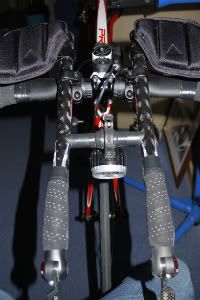

as a new tri bike owner I was evaluating the options further and another practical question came to mind.
where do you attach a largish headlight on atri bike?.
In the video of the exposure lights, the Strada looks a lot more visible in daylight than the Joystick, but where can it go on a tri-bike without my hands being in the way? I could get a bar mounted light such as the Strada or an alternative for my road bike and use something different on my tri-bike.
Make one of these:
http://www.slowtwitch.com/articles/images/3/23203-medium_lupine_piko_mounted_top.jpg
http://www.slowtwitch.com/Products/Lights/Stay_Safe._Be_Seen_Lupine_Piko_3_1836.html
