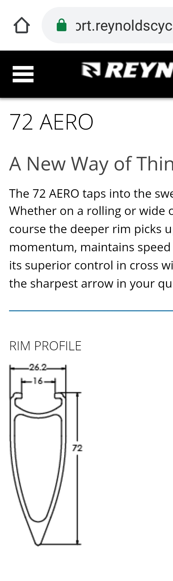

huh??? I think you are thinking of the wrong wheel. I have an aero 72 and use a 25mm tire on it and the aero 90. From slowtwitch, they tested it with a 25mm tire, https://www.slowtwitch.com/…_58_and_72_3957.html
The 700x25mm tires measured right at 26.0mm (at 100 psi) – just slightly narrower than the 26.3mm rim:
To the OP this is a great , fast rim, I bought the 2016 model, it states 16mm width internal, 26.2 external, which easily fits 25mm tires. This one:
https://support.reynoldscycling.com/wheels/72-Aero
Much better wheel than a HED Jet 6, not sure why a wheel just 2 years old would be as cheap as this other guy thinks.

It’s a 16mm internal width. Does that matter for the tire? I regularly use 25mm tires on these, it seems like a wide rim to me, since its 26mm external. Most of the reviews and tests also 25mm. I think it’s funny how a 2015,2016 wheel can already be considered out of fashion.
