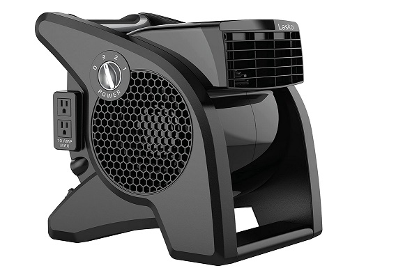

There are fans and then there are blowers that actually do a better job than most any fan.
Get one of two of these. You won’t regret it.

It wasn’t meant to be a snipe at your post. The vast majority of people’s trainer setups I’ve seen were way under ventilated. I actually used a precision anemometer to compare all the fans/blowers I could get my hands on. The Lasko blowers literally blew all other devices away outputting an impressive 36mph blast when set on high. Most box fans struggle to output 12mph zephyr. No wonder they don’t cool worth a darn. Plus the Lasko blowers are super quiet too.

I have on of these. FWIW, I find it to be very ineffective. It was okay when I was riding indoors. When I switched bike riding to garage, it doesn’t come close to being enough (Texas summer heat). My other fan is far more effective. So, personally, I would avoid the blower if you are heavy sweater.

Did you mount it on a stand inches from your body? I’d agree if you’re trying to use one set several feet away they won’t be that effective. For the bike I built a stand to place one very close in front, actually touching the front tire near its top and on the side raised up ~ 18" and placed as close as possible.
The Lasko blowers work amazingly well, and the lower noise is a nice benefit too.

True but velocity is only a component of convective cooling. What’s really important is air volume being moved. Doesn’t really need to go top speed.
Bottom line though I agree. Get the best fan available.
