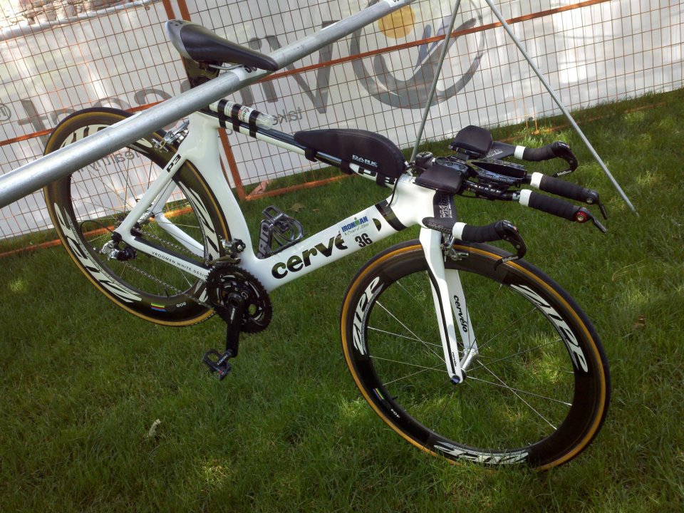

Lots of good questions. While we can’t claim total objectivity, there are some better and far more aero options over taping stuff to your top tube. We think it is kinda crazy to spend big bucks on a sweet aero frame and a super aero wheelset and lose all of that with a train of taped gels on your top tube. Some photos of a few better storage options:
http://www.acmebicycleco.com/wp-content/uploads/2011/06/Blue-DSW-Virtue.jpg
http://3.bp.blogspot.com/-OjP-htP_m44/T_XCANnfR4I/AAAAAAAAAmo/dFOOtoWnzcA/s1600/205223_435058733193692_139648733_n.jpg
