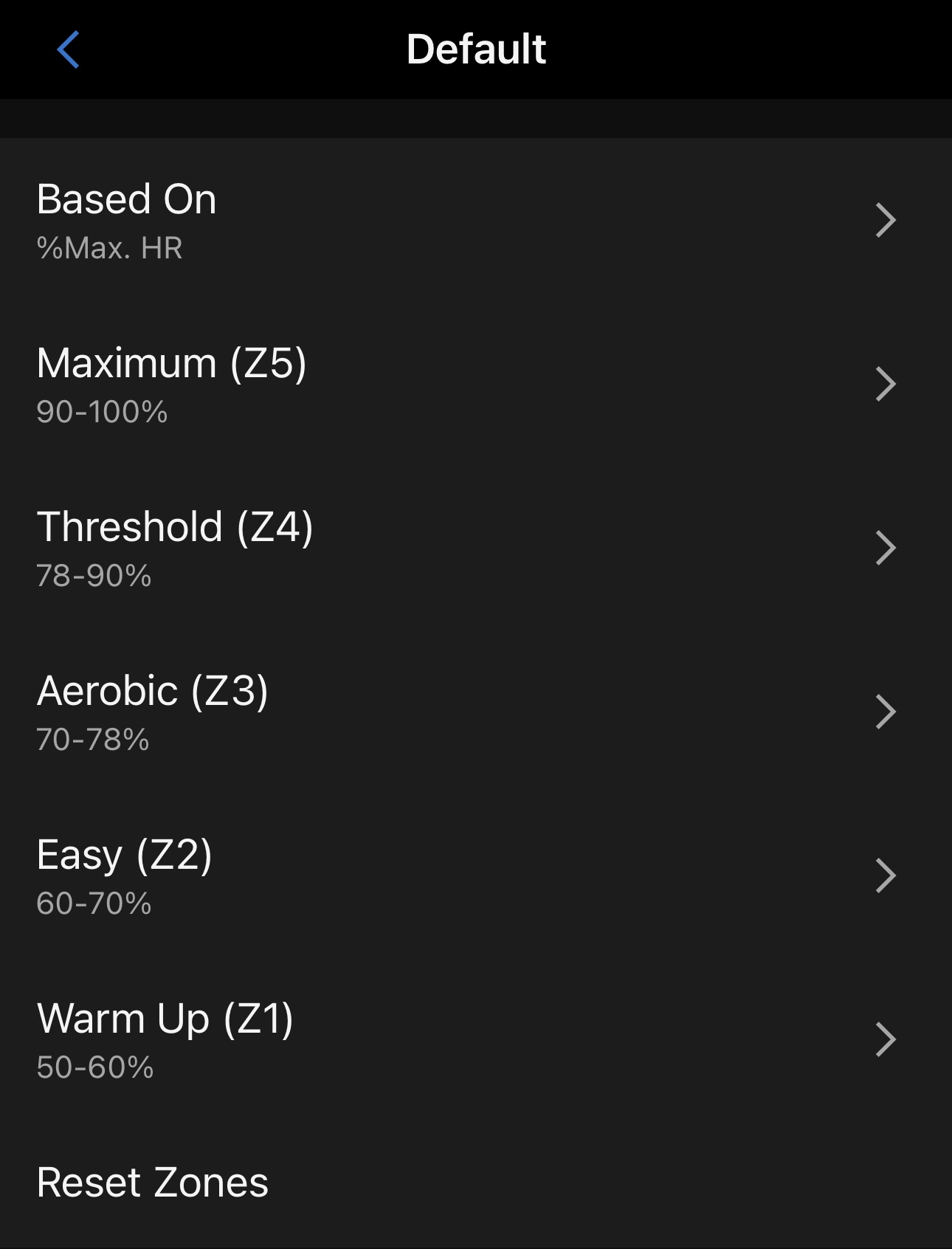

When running over the summer I noticed (due Garmin upgrade) that I always seemed to be in Zone 4. I took 2 months off running November/December and now I’m getting back into it this month.

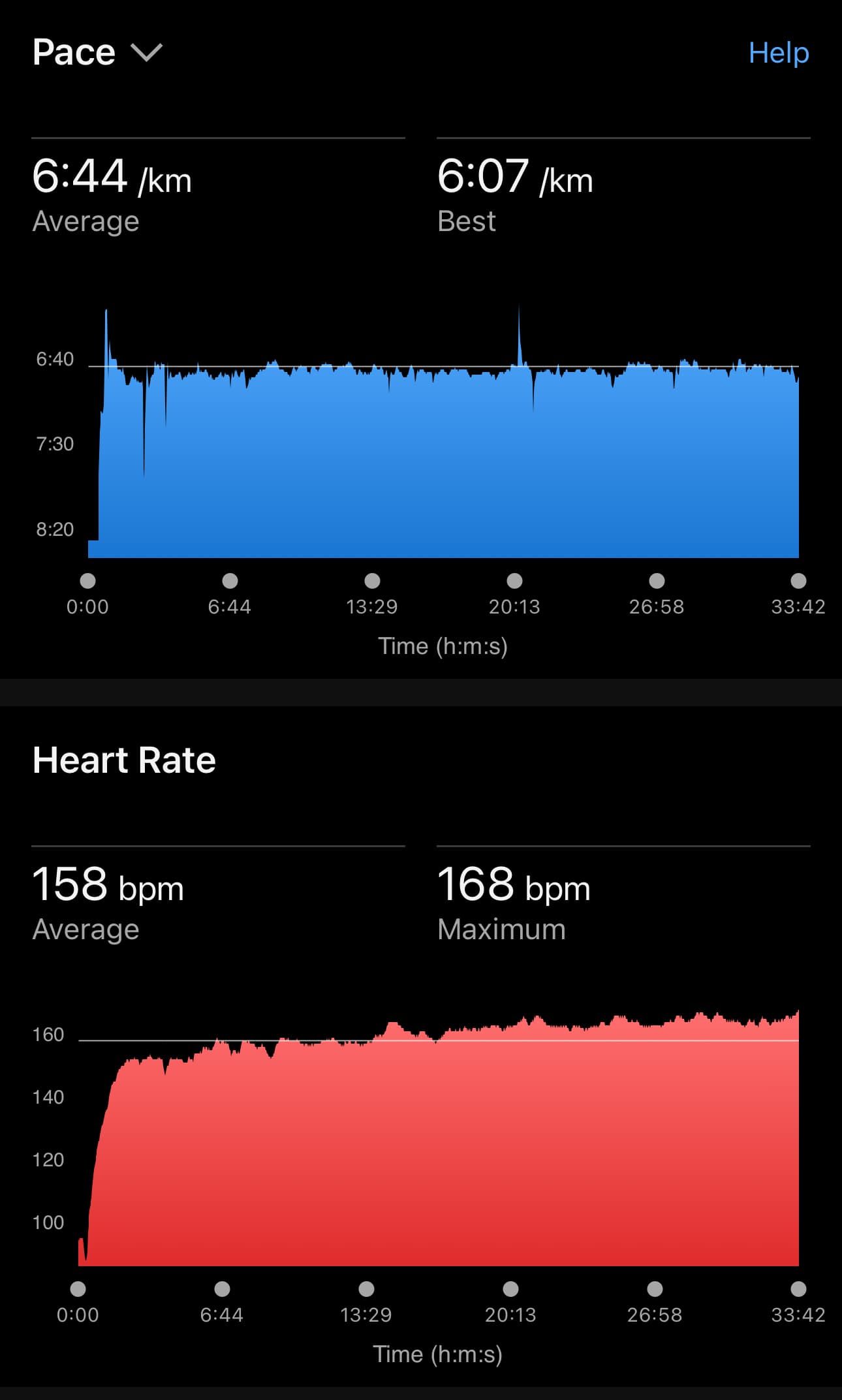

Today I decided to try and keep my heart rate low and run slow. Set the treadmill to 9kph, which felt easy. Knew I wouldn’t be able to hit Zone 2 but was hopeful for Zone 3. No chance, Zone 4 again.
I can’t go slower. If I go slower I’ll be doing some sort of weird speed walking. How do I need to train to get my heart rate down? Any good training plans for this?
Info: Female, 43, according to Garmin HRmax 189, currently running 3 x 5K per week treadmill.

Your zones do not look right for a MAXHR of 189. What method are you using to set your zones? That kinds looks like heart rate reserve. Do you have a recent 5km or 10km race? I prefer the threshold method using avg 10km race heart rate. As a 56 to male with a max of 184, my 10km threshold is 174. Which puts my mid z2 at 152. So, I don’t think your zones are correct… You aren’t running in zone 4.
That said… What stick out to me from your hr graph is that it is constantly increasing until you stop. That’s indicating that you are running too hard. You are probably in z3. So, you do need to slow down until you can see a flat hr graph after about the 10min mark.

They are the default ones on Garmin.

But, those default. Garmin zones are way too low, and way too big. That zone4.goes from 147 to 169 bpm. For me (with a similar mhr) that covers all of z2, z3, and part of z4.

The OP is running to fast… I said that above. Her heart rate is increasing for the entire 30 minutes, instead of plateauing around the 8-10 minute mark and stay there for the remainder.
I expect she needs to slow down by 40s/km. Targeting a heart rate around 154. But, that’s presuming she has a 5k/10k heart rate that’s around 178 or so. I was hoping she’d reply with one, to be a little more specific. Something in the low 150s should be fine. But, the key is that her heart rate during the last 5 minutes should still be the same as the first 5 minutes after a 10m warmup.

I love their watches and computers, but their algorithm for zones seems so bad. They measure what feels like a viable max heart rate, and then seem to use some other number to calculate zones.
If you’re using Garmin’s defaults, do a quick check in your User Settings, to see if your age, birthday are correct.
The Garmin’s default for zone 5 is 90% of HR Max. If your Zone 5 starts at169 bpm it would be using a max of 187.7 bpm (close enough to the 189 you said). However, that’s closer to a max HR of a 31 year old, not your age of 43.

All of which would still put your zone 5 starting at about 151bpm.
The workout you posted will still show as being in zone 5, but the zone values would be more accurate.
Garmins allow you to override defaults and set your own customized zones too.

Since she is holding near 160 for 30 minutes amd claiming she can’t go slower, her max is likely close to that 189 value. She’s probably running in low z3, as defined by LTHR based zones. That’s a pace that “feels” good and productive for short workouts.

But the answer to why she’s in zone4 has nothing to do with any plan. Simply, her watch is setup wrong. Shes not training in z4.
