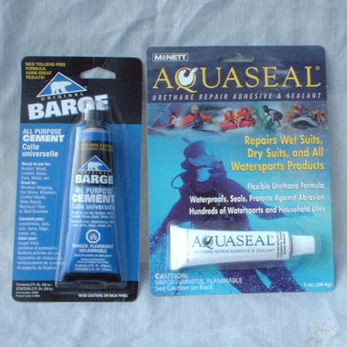

Use IronMend to patch the jersey fabric from the inside, then use AquaSeal to fix the neoprene (or just take it to a surf shop). I have an older Helix; great suit, but the seam gluing/stitching was weak in some areas, so I’ve had to patch it a few times.
IronMend
http://www.amazon.com/…-Black/dp/B000GT471S
https://i.mcnett.com/uploads/product/variant/image/24/large_16110_ME_IronMend_Comp.jpg
AquaSeal
https://www.mcnett.com/gearaid/aquaseal#10110
http://www.theboatpeople.com/images/products/aquaseal1pt.jpg
