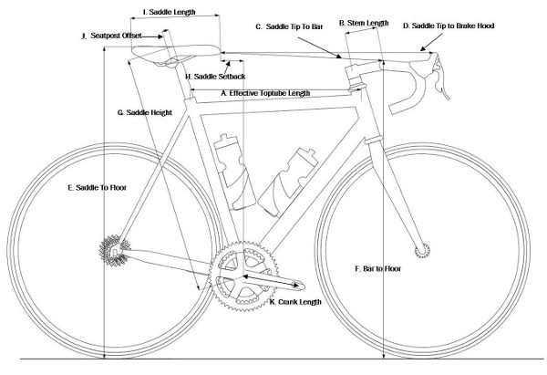

I think I need an actual bike fit process. My decades-a-cyclist husband was relatively insistent I just need to practice. Fair enough, but I feel like I am putting so much weight in my hands- my arms are quite LONG, so this is kind of a mystery to me. I can’t tell if maybe my saddle is dumping me forward?? That’s kind of what it feels like…Anywho, everything you said makes sense, as per regular-sized bottles, and which one and how to reach, and I do have two cages. I SHOULD also have great balance, as I am a Pilates teacher (for 18 years now) - my theory isn’t playing out well on the bike. I have a lesson upcoming face to face with a skills teacher (who is awesome, anyone in NYC ask me for the reco, she’s fantastic) and thank goodness, because my practice on my own has not felt productive. In fact it kind of leaves me almost in tears.
My general opinion is that frame geometry has become too steep across all sizes. Compound this with the rider sitting even steeper to solve a ‘reach’ issue = hand pressure, saddle pressure, etc.
Feel free to pm me your measurements, but let me guess where you are right now:
your saddle ‘setback’ from the bottom bracket is about 4cm (distance to nose of saddle from vertical line bisecting bottom bracket)
You are on 172.5 cranks. Your saddle height is +/-680mm
You have a short/wide saddle with a cutout, yet try to sit as far back as possible on the saddle?
