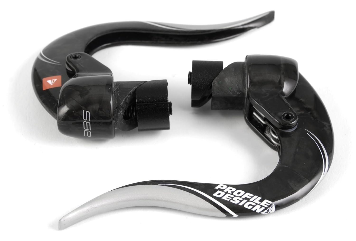

Hit me with some aero TT brake levers
Hi guys,
Unfortunately I took a tumble on my bike the other day and I need new brake levers.
I don’t really fancy the Di2 since they look so freaking big and can’t possible to very aero. Obviously the gear changing ability is golden if you ride hilly courses but I’m fine without.
What are your favourite aero brake levers? It needs to fit the standard Felt IA bayonet.
I was looking a bit on the Shimano DA 7900 TT levers. They look very sleek.
http://oi58.tinypic.com/315eae0.jpg
I’ve also looked a bit at Campys aero carbon TT brakes which looks pretty sweet as well.
http://oi61.tinypic.com/f0b1hh.jpg
Wanna throw some options into the mix?
Thanks! :slight_smile:

I’ve used TRP alloy and carbon brake levers in the past.
Have recently upgraded to the 6870 TT groupset hence using the di2 levers that came with it.
It feels to me that the TRP carbon levers were easier on the fingers in the long run, but I feel that the added bonus of the ability to change gears on the pursuit bars is really helpful (Especially coming out of corners & U-turns).
So answering your question, which ever levers u go with is very personal but I would definitely go with Carbon.
Vision crabclaw levers, original version. They are really uncomfortable on your fingers, and so discourage you from braking too much. Which helps you go faster.
some outdated comparison pics: http://university.tri-sports.com/2010/08/11/stop-triathlon-bike-brake-levers/
Bontrager XXX Aero. Light, solid feel, comfortable, aero, adjustable reach, integrated barrel adjuster, return spring.
I have a set of these in the cart at Nashbar, just waiting to pull the trigger.http://ecx.images-amazon.com/images/I/71wYxSQBk0L._SL1500_.jpg
x2 on the Bontragers.
The return spring is a big plus, preventing the Vision crab claw rattle…

I have been very happy with my TRP RL970 levers. Very comfortable and simply have a good feel. You can use them all day long and they will never bite into your hands.

Don’t buy those. Please, I beg you don’t buy them. They are the worst brake levers I have ever used. When I used them with the TriRig Omegas, they did not pull enough cable to have confident braking power. I switched to Dura Ace levers and all the problems went away.
http://www.3tcycling.com/road/en/bike-components/road-bike-accessories/aero-brake-levers-pro/
These are about the smallest cross section area ones that I could find which would fit standard bars. Their power is OK, not great, they do have a return spring, they require a different cable (MTB I think).
power is fine with those on tririg omegas, way more lever motion than needed. unlike the vision nes, they use standard mtn brake cables. also, cable is internal so you can rotate 90deg without worrying about housing,etc, if that is something you wanted to do(see photo of 3:18 100mi TTer :slight_smile:
A band made from an old inner tube helps with rattle on the Vision lever. Acts like a bit of a return spring.
I have used them for a couple years with an omega front and I don’t worry at all on the flats. I have had a couple of “poop your pants” moments on some down hills, but that might just be because I have zero experience on fast technical descents. It also doesn’t help that my other brake is the legendary P4 rear brake.
