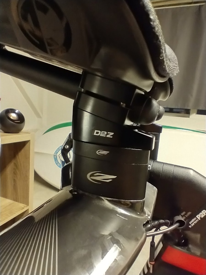

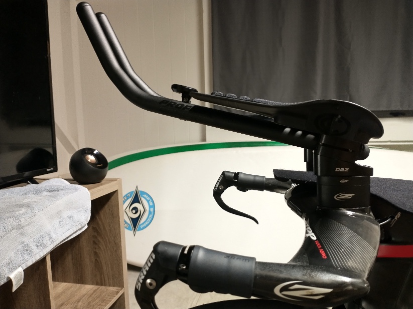

I have a Vuka Aero base bar, which is similar. I believe the difference is that the Vuka Stealth has a built-in stem. I’m on a circa 2014 TM01. I angled my extensions and cups by combining Zipp risers with a Drag2Zero angled riser and pole clamp. I use Culprit cups and 400mm Profile 50A extensions. This setup is solid and comfortable and I’m really happy with it. I will send a picture and the product links tonight. I think what I have is exactly what you’re seeking.

Below are the photos and links I described earlier today.
I used the Zipp riser first, because that sits nicely in the base bar. There is no tilt on that. I have actually paired 25mm and 10mm risers, because that’s the height I want. I can stack the risers by doing a minor amount of filing on the 10mm (top) riser and using bolts that are 10mm longer than the bolt for the 25mm risers.
After that, I added Drag2Zero’s 15 degree angled shim and pole clamp. Use the D2Z angled shims technical guide to verify your risers’ bolt spacing will work with them.

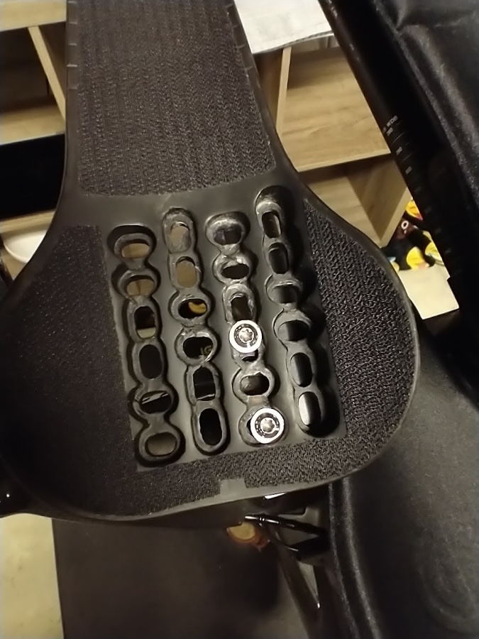

Finally, there’s the Profile Design 50A extensions and Culprit pads.

I went from Zipp’s 70mm to 110mm extensions to the Profile extensions, which are also longer, to get the height, length and wrist comfort I wanted. I always used aluminum extensions because I could find and trial them for $50 or less.
