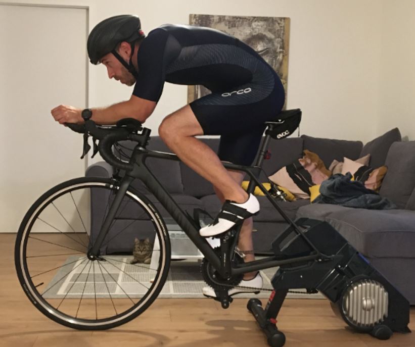

At the moment i am trying to figure out why im so slow on the bike, although i think my position is not that bad, considering that it is only a road bike with aero bars.
I am 175cm tall and weigh around 69-70kg. my ftp is around 220 (yeah not that high sadly) watts and i am aiming for around 190-200watts at race day.
My current training course has pretty average surface, but is a 8km straight road with low traffic - pretty sweet for testing stuff.
MyWindSock is rating my current setup at between 0.30 and 0.32 CdA - which is horribly bad as i think.
Please find a picture of my current position below.
I tried alot of things with saddle height and bar angles but after a few tests, this position seems like the fastest for the possibilities i have with this bike.
Still i think i could go alot faster for the power i put out.
My last session from today, gave me a CdA of 0.306 at an average speed of 31,1 kmh with around 170watts.
I don’t know where i am loosing so much speed - most of the people i talk too have horrible positions, they dont tuck in their shoulders, head up in the air and still get CdA around 0.26 to 0.27.
Do you have any suggestions what i could try out to be faster?
thanks in advance :slight_smile:
greetings

For clipons that position isn’t horrible but do you hold it all the time or cheat up some? Front view so we can see pad width?

the bars and pads are as close together as possible, my forearms are almost a straight line.
im trying to hold that position like 95% of my ride when testing stuff.

That the endurance Canyon rim brake model? Looks like it.
If so, stack on that versus a aeroad or race version is taller. Meaning less aero on the clipons.
Also, if so, the tires Canyon list for that are 5w a piece slower than a GP5000 without latex tubes according to BRR website.
Next, thats super narrow pad width. I would widen it and do more work to adapt to the position. I would buy a big negative rise stem if you want it more aero instead of pad width. In my experience on clipons back in the day, pad width hurt my power more than I gained in aero versus addressing the stack.

First-position doesn’t cost anything. If you can get lower (lose the spacer and slam it) there will be cda gains to be had if power isn’t sacrificed. Younger/flexible athletes can do this easier than old farts like myself. You want the smallest profile heading into the wind.

thanks, im trying to get the flat dust cap from canyon to slam the stam conpletely (there are no spacers left) but they are not answering my mails sadly - would make me 2cm lower in the front.
on the picture that is my race fit suit already, its super duper tight and comfy - cant get any better.

Your position looks fairly high and a bit bunched up.
My thoughts: you basically need to take your position and rotate it forwards around the bottom bracket.
What saddle are you using? Try a proper tri saddle.
What’s your seatpost? Can you get one with a forward offset?
Stem - get a steeply angled stem (like an old MTB stem) and mount it upside down (I use a 35 degree stem).
That should get you into a lower and comfortable position.

Your power to speed is pretty close to what mine is on my road bike, and you get slightly higher mywindsock numbers than I get when I’m riding low and aggressive on my road bike.
I’d actually be interested in seeing what you could do with an aero helmet, GP5000, latex tubes, optimal tire pressure, and then get in the drops, bend the elbows, get low, and see how fast you can go at similar power output, and compare comfort as well.
Your position is pretty good. Keep in mind that people getting CdA in the mid to low 0.20s are doing so on aero frames with deep wheels, wearing aero helmets, etc.
The drop bars produce significant drag and sit out in “clean” air; you’re on a road bike so nothing you can do about that.
Move the bottle cage on the down tube to a setup between the aerobars so that the bottle fills in the gap between your forearms.
