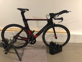

Height: 178cm (5 ft 10) Inseam: 79cm No issues with back. Flexible hamstrings. Mildly tight hip flexors but stretch them a bit and not overly bad. Distance from pedal to middle of saddle following the down tube angle: 91.9 cm Distance from the tip of the saddle to the centre of the steerer tube bolt hole measured horizontally: 43.3 cm Bike - Felt DA 2014 - 54 medium Stem - Bayonet fixed stem 100mm 60 degrees Bar - old Bayonet 3 with Profile design T2 bars moved as far forward as I can. No more room to move arm pads. Arm pads angled down about a cm. Saddle - Specialized Sitero Crank - 172.5 (same as my road bike)
I’ve copied the distance from pedal to saddle and from tip of saddle to steerer tube from measurements I had on my old bike which was a Felt B12. However the saddle on the B12 was a Adamo prologue and the B12 had a normal stem that I think extended my reach a bit more. The current fixed stem is tall but stubby. Overall, it feels ok, but maybe a bit bunched. Also, there seems to be a bit of rocking in the video from rear.
Hoping to get general feedback on fit and also if my ideas for upgrades are ok.

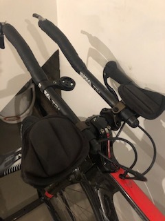

Get a new fixed stem which will be 100mm x 30 degrees. I calculate this to be 3cm longer and 3cm lower. Get Cee Gees pads which will probably give me about .5cm higher pads. Change to some T1 bars with ski bend. Push out 3cm reach wise. I can buy the profile design riser if I’m dropping too much with the new stem. Will soon change to a new crankset and thinking 165cm.

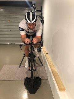

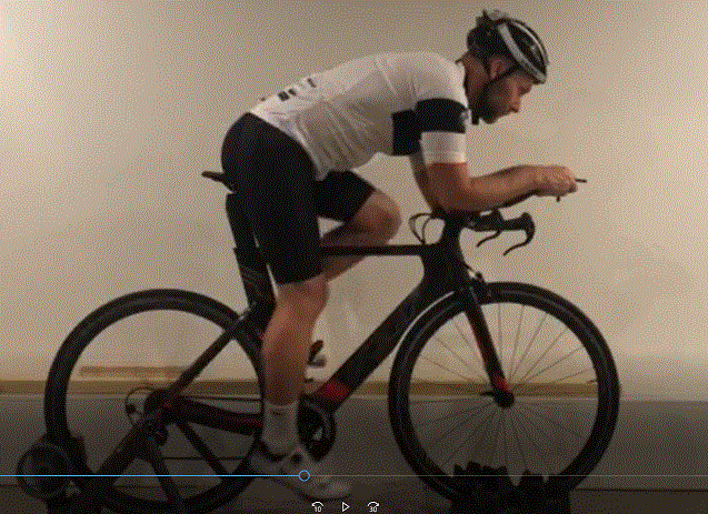

So here are the photos and videos.

Looks like your saddle is about 2cm high.
Don’t listen to me, just recording my thoughts for posteriority.
Seat looks high.
Need more reach. Need pads further forward and likely longer extensions.
Looks like you could lower the height of the front end as well.
Ok - based on the feedback, lowered the saddle 19mm and posted an updated new side shot video. Seem better from a pedaling perspective. Wonder if I could go a touch lower at the back.
Any more feedback on what I should do (apart from losing the fat gut), let me know. Will look to order the new stem soon that will give me 3cm more reach and lower front end as well. FYI. I’ll probably go and get another bike fit, but want to have a play around first and any parts like a fixed stem or new cranks are not something the fitter could change easily anyway hence asking here if its a good idea.

Toss the saddle, it’s not helping you. Get 165mm cranks.
Yes to new stem, absolutely positively yes to ski bend extensions, yes to having proprietary aero risers on hand for adjustment, and yes yes yes to 165mm cranks.
Finally, your seat is probably still too high in 2nd video. Tilt saddle downward to compensate.

Thanks for the feedback. For the saddle, this is literally the first time I’ve sat on the bike with it installed so moving around a bit and not used to it (also havent been on a tt bike in 4 years). Are you suggesting ditching it for something like an ISM?
For the ski bends, the main reason I’m thinking they’d be good is they raise my hands a bit more in front of me and I can angle them in a bit so my hands are closer. Will try bringing in the armrests a bit closer but will try that once I have the new stem.

I’d try all of the ISM saddles, the Fizik Mistica, etc. and find the optimal one. These types of saddles are meant to be tilted slightly down. This is rails level for most of them.

His head is up so high, front end definitely seems like it could come down. Gonna take some practice to really get that shrug nailed and keep the head out of the wind
100% agree on ski bends, look at that bent wrist position. Definitely not comfortable.
Shorter cranks should help free up some room and less interference from the so-called “fat guy gut” lol
He can lower the head without lowering the front end… the opposite really. Once done that’s like 75% of the battle though.
Ski bends have nothing to do with wrist position for me, but do probably make wrists more comfortable if that’s what you’re into.
