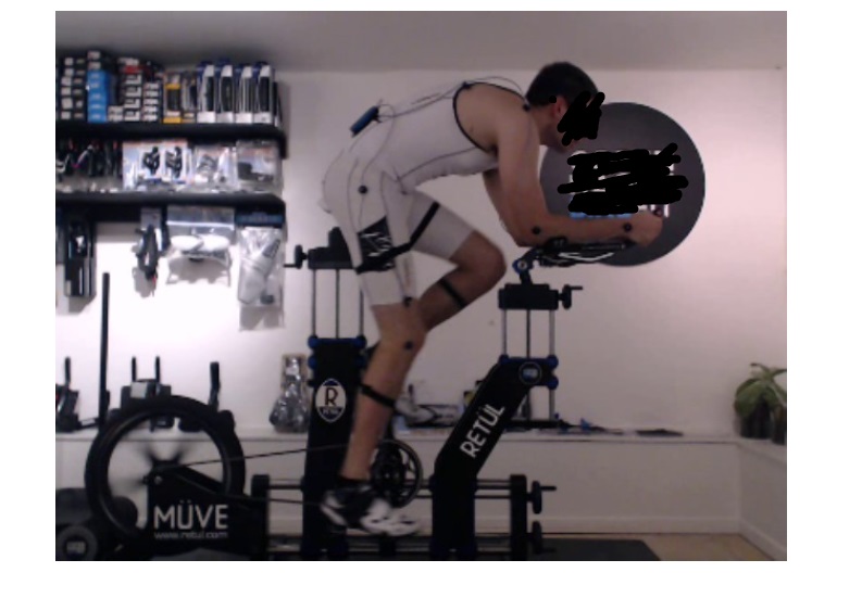

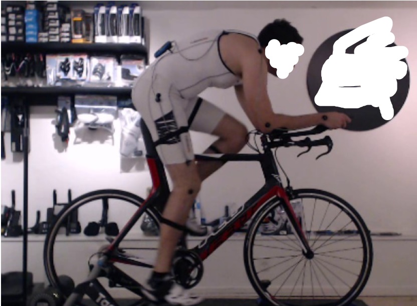

I have attached the picture after being fitted on my current B14 size 61. I have a picture from the muve fit which i for unknown reasons cannot acces from here but will upload later.
That fit is t bad at all, but I’d definitely stretch you out a few more cm.
Position looks fair, but your face looks terrible in this pic.

  2. Arm pad stack BB is in the 700 range, am i correct, assuming the arm pad X (reach) is the Arm Pad Reach BB: 478 mm (for attached picture, muve fit file)?
  3. The real fit and muve fit has some difference in the numbers, are these the adaptations you would expect or have I been fitted far from muve fit? Muve:725/478, Felt: 714/432 (attached is muve fit numbers and picture of that position)
    4: The muve fit says i should be on 172,5 cranks but they are 175 on my Felt, is that an issue?

One side note: The cnayon speedmax can not accomodate my stack. But i fint it wierd that even the Size small has too much reach, how does that make any sense?
Thanks, and thanks i guess, haha :wink:
