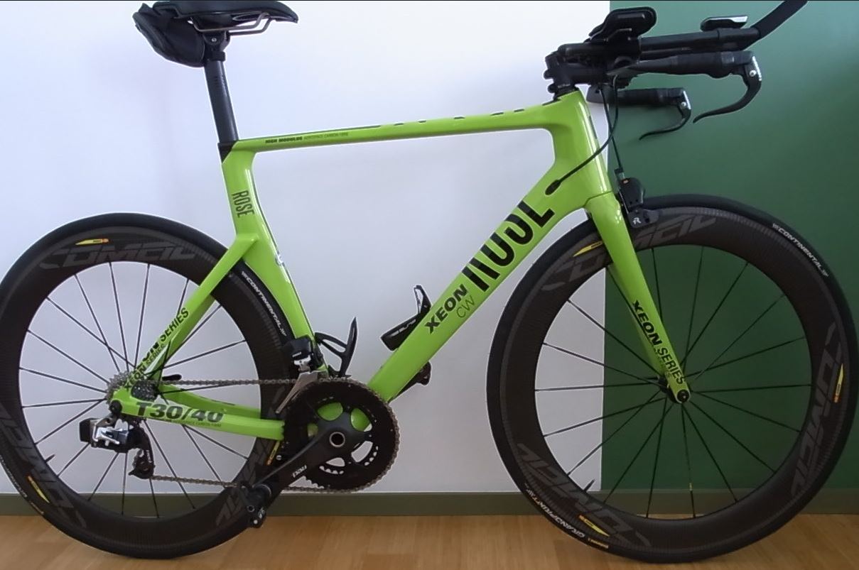

Have a look at
https://www.rosebikes.de/rose-xeon-cw-ultegra-di2-2673213

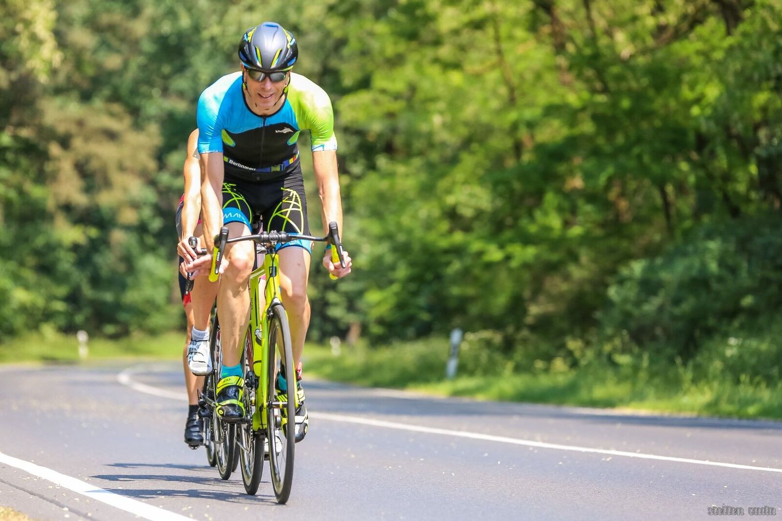

I rode the Bike for exactly that purpose and LOVED it.
Should you have questions, let me know.

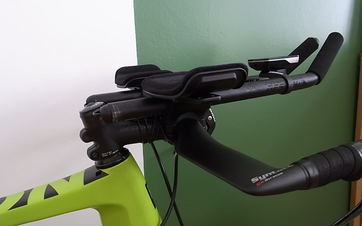

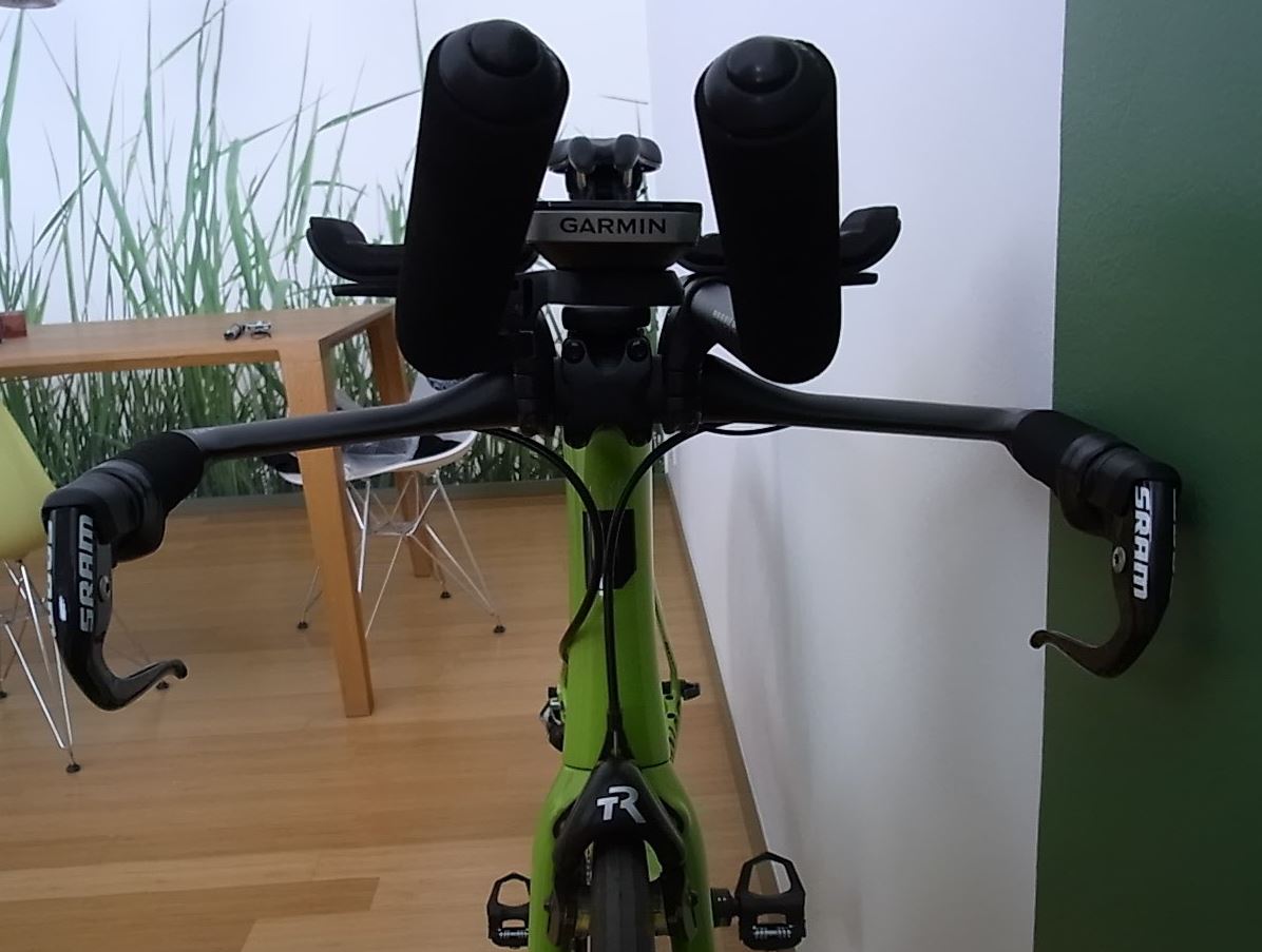

Which aerobar did you put on it?
Is it comfortable for long distance Triathlon?

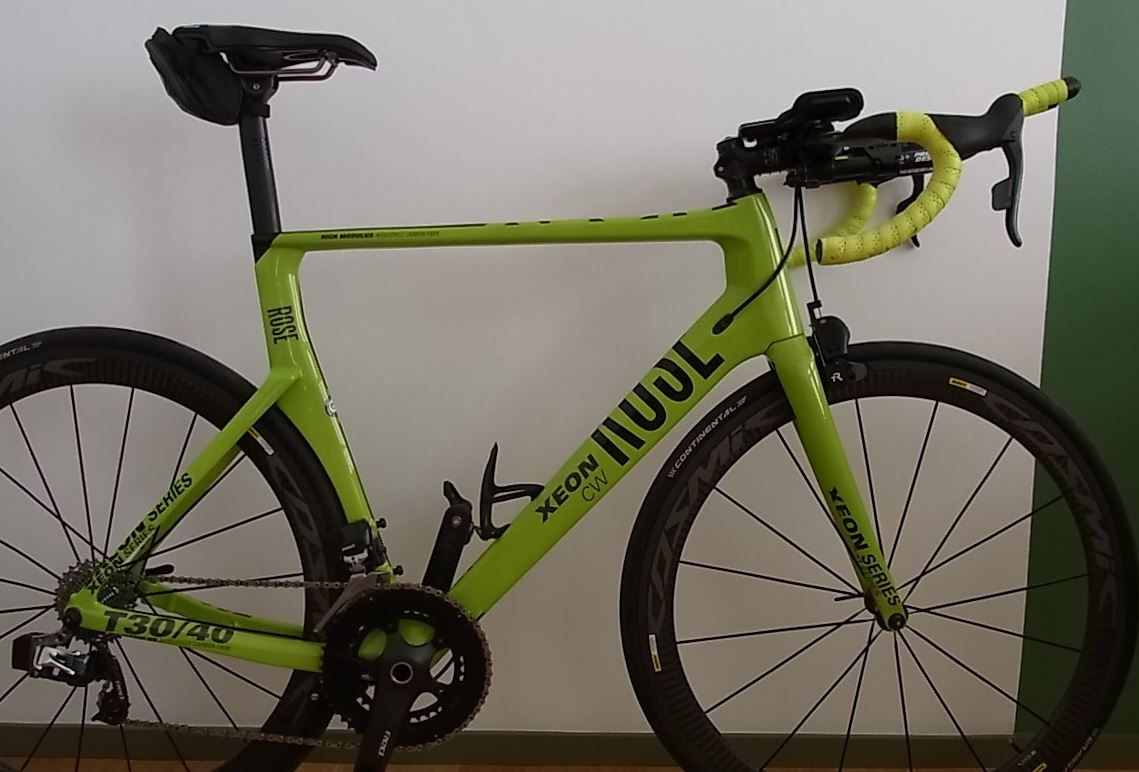

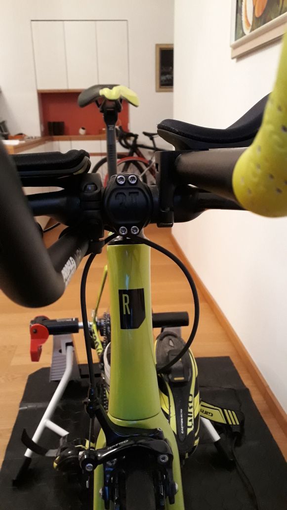

I started with Clip-Ons on a Dropbar and later converted to a Tri Basebar (still with Clip-Ons though) and TriRig Omega X. My Basebar was Syntace Stratos CX and the Clip-On Profile Design Supersonic (J5). One thing I like about the Rose-Bike is that it uses standard components, so you can use whatever you want - with integrated Cockpits like PD Aeria Ultimate, TriRig Alpha or FSA Metron it should be even cleaner.
I didn´t do LD (only half distance), but the Bike is comfortable and can be fitted in a wide range. The only things you should keep an eye on is seat-angle (when reversed the seat-post gets you 76°, but with a split-nose saddle I was getting further forward) and maybe length of headtube (the geo is not very low so you might take a size smaller and slam the stem). Anything else is really very well designed and suited and I also like Rose as a manufacturer (you can customize anything you want and they´ll build it for you).

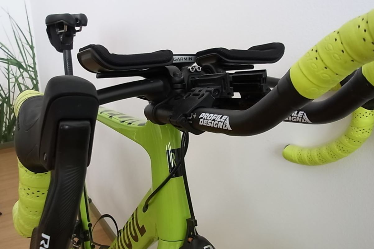

Do you have picture with road bars?
Thanks
I sure do… The dropbar was a 3T Aeronova and while it is Clip-On compatible it flattens next to the Clip-On section, so you need to find a Clamp/Bracket that matches. I started with 3T - that obviously works, but has a lot of stack. So my final solution was Profile-Design undermount that I had to rise 5mm to stay clear of the flattened area of the dropbar.
With electronic shifting it is very easy to change setup and I also never changed seat-position when toggling between road- & tri-use. Of course you have the additional drag of the drops of the roadbar…
