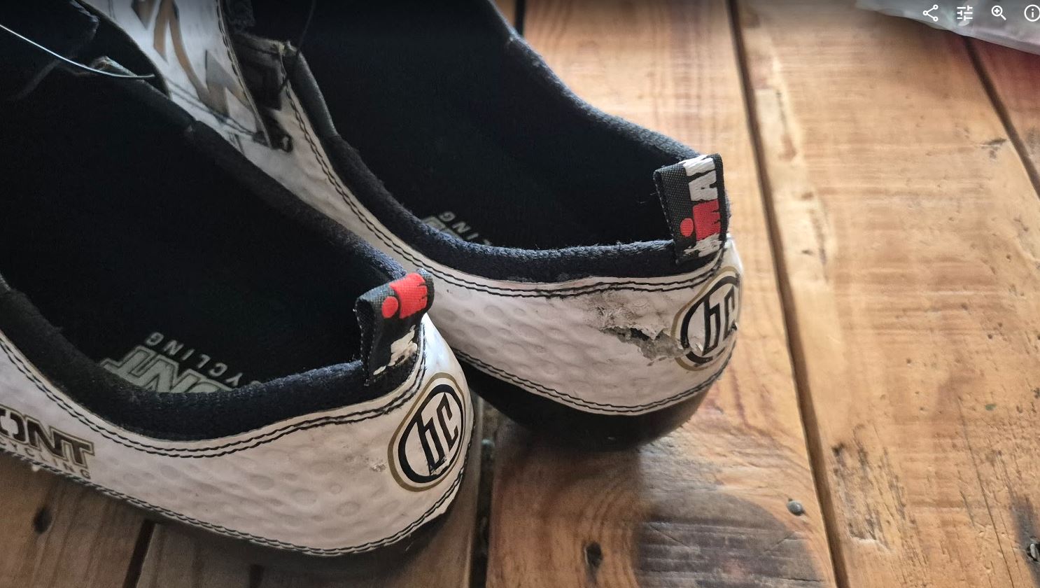

Here is what I did with an old IM wristband and a bit of DIY.
I was fed up with my shoes rubbing the pavement at T1 as you can see with the big scratch on the picture.
Basic skills for sewing needed.
How do you stop them from running when you come in off the bike?
No solution for T2 sorry, but the risk of rubbing is halved and it also helps for putting shoes on. For an almost cost of 0 which is rare for triathlon equipement :grin:
