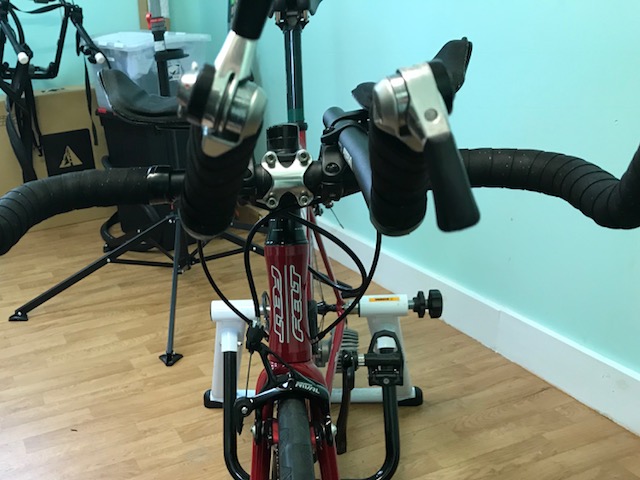

I’ve got a 2007 Felt S32 which is a solid bike for how old it is, but leaves a lot to be desired with the bars and external cable routing.
I just installed a new set of Profile Design T3+ bars to help out and I’m thinking of getting the PD T2 Wing as well.
Any help or tips for cleaning up the front end would be great. I’m considering just taking it down to my LBS and letting them do it, but I wouldn’t be against doing thing myself. The only internal cable is the rear brake.
Would going to a center pull front brake like a TriRig Omega help? Would I need a cable stop someplace?
Should I just get longer shifter cables and ziptie them together in front of the head tube?
I’m not really sure what the best course of action is here.

Hard to visualise your routing from a 3D perspective, but for me I made mine a little tidier by crossing the shifter cable to the opposite side’s downtube boss, then crossing the bare cables again on the run to the bottom bracket.

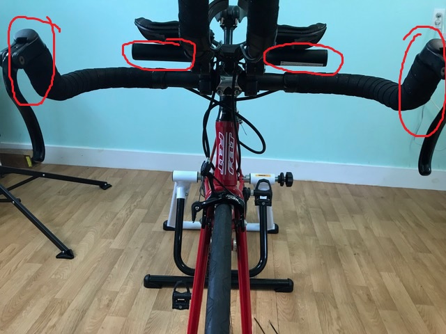

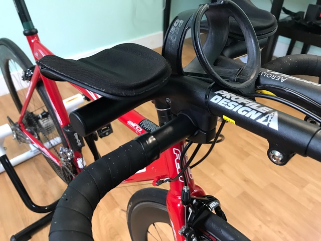

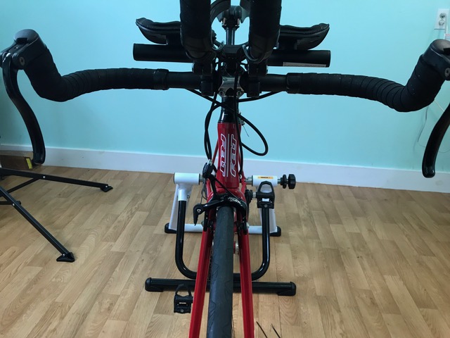

Here are two pics with the only bars on (you see the bars are L shaped with the pads resting on the shorter part)
Anyway, the cable for the brakes cross over with the front going down to the brake and the back going into the top tube on the opposite side from the brake lever.
The shifter cables were ziptied to the extensions to make it cleaner (they are internal on the new T3+) and then they run to the headtube where there is a clip and then they run externally down the down tube to the bottom bracket.
I hope these help you visuaalise it better. I’ll be totally recableing the bike when I get the new basebar, so I’ll have a few more options then I think.

While I agree neat cables are important, if it were my bike I’d start by getting rid of the unnecessary aero obstructions. eg cut down the base bar ends to leave the tips horizontal, and those elbow pad support bar … things:

Also make your front brake cable shorter so it sits in front of the head tube, not out to the side.

Already taken care of.
In the OP I have the new picture with the T3+ bars. That was my first change. I’ve got plans for a new base bar as well.
