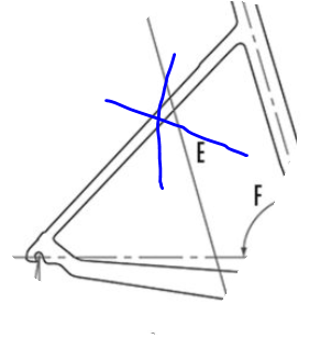

Mid - May I go off to FLA to ride for a week. I take the bike into Trek Clermont to have a new chain put on. Just want to add Trek Clermont - really helpful, friendly, great advice, loved the experience of just popping in, highly recommended. I pick up the bike and as we are going out to the car the mech guy says ‘‘you do realise you have a crack in your seat stay’’ I stand there for minute and say ‘‘no’’ he shows me and yes it looks like a crack. This is the seat stay on the same side as the derailleur. They tell me to stop riding the bike and take it back to the Trek store where I purchased it from as soon as I get home.

What I think they are saying - when the derailleur snapped - no fault of mine! this is when the damage was done. Ok get that but surely when they replaced the derailleur the mechs at Trek would have noticed the seat tube was cracked? and if so would have informed me that it was highly dangerous to ride on the frame or does that indicate there was no crack at that time?
It may be worthwhile to send pics to carbon repair shops. Search this forum. I believe cyclocarbon is one. Still out of pocket $$, and possibly without a bike for a few weeks, but could be better than the laughable discount the OEM offered. As a bonus, if you do go this route, you get to let everyone you ride with, about this interaction with the OEM, and LBS.
Eta, your story changes also. Which part is damaged? Seatstay or seat tube?
