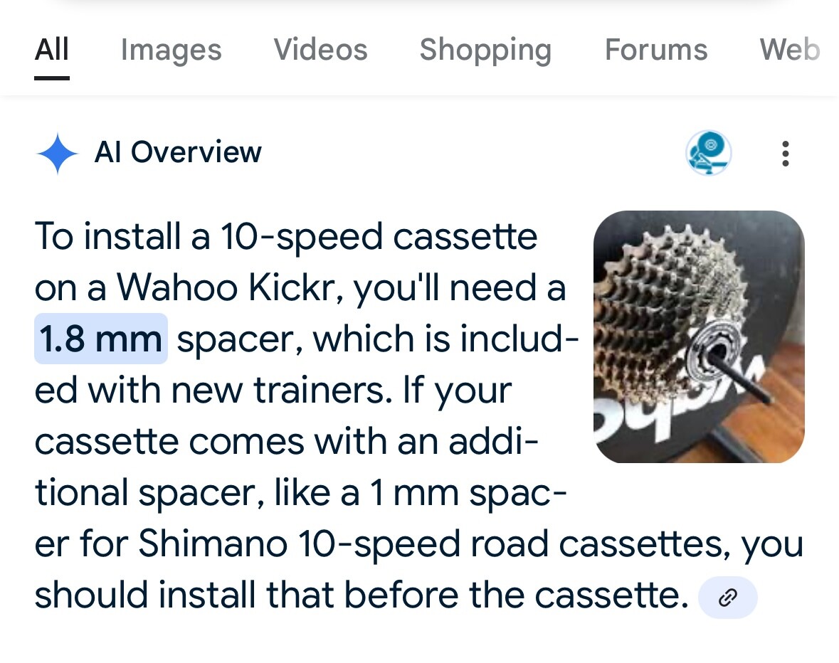

Thanks for the reply. It seems like I “might” need 2.8mm? But also maybe 1.8 only?
This is what I got from Google fu…?
“It seems like I “might” need 2.8mm? But also maybe 1.8 only?”
You need both spacers (as the article you’ve pasted says). I am assuming that you have the stock Shimano HyperGlide 11 (HG 11) compatible freehub body “compatible with Shimano HG, SRAM PowerGlide (PG), and other cassettes with 7-12 cogs. This is included with KICKRs and CORE.”
But is your cassette mentioned above e.g. a Tiagra 10-speed (road)? CS-4700 (see below)
Prove this to yourself by putting two 1mm spacers there (as a sub for ‘just’ a “1.8 only”) and you’ll find the lockring bottoms out.
"10 speed cassettes’ overall width is actually smaller than that of 8 and 9 speed cassettes . . so . . . requires a 1 mm wide spacer.
"However Shimano “builds in” the spacer on some 10-speed cassettes. For example: Tiagra 10-speed (road) and many MTB 10-speed cassettes have a bit wider spider so there is no need for adding the 1 mm spacer.
"On an 11sp freehub a “10 speed cassette requires an additional 1 mm wide spacer (along with the 1.85 mm wide one) (for catches and caveats, see the [10-speed freehub] section above and the [8-9-10 speed freehub section]”
This plus the 1 mm, i believe
