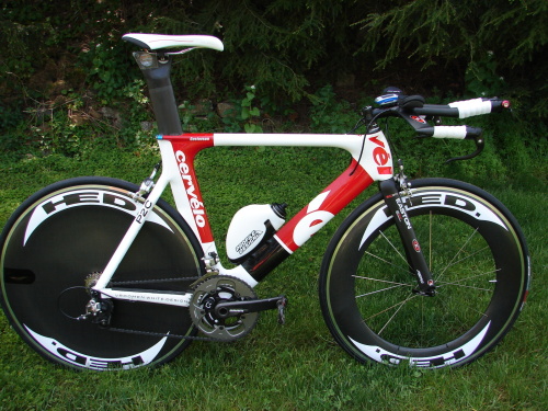

I’ve got that exact combo on my P2 - there is no noise that i’ve ever noticed, yes they can be trued and yes they’re a fast a$$ wheelset. Get a set of latex tubes and a pair of Bontrager R4 aero TT tires and you’ll be set. here they are on my bike
http://forum.slowtwitch.com/images/users/images/8/15488-large_5wxp92.jpg
Thats looks very nice! I try to imagine on my Scott Plasma TT :wink:
