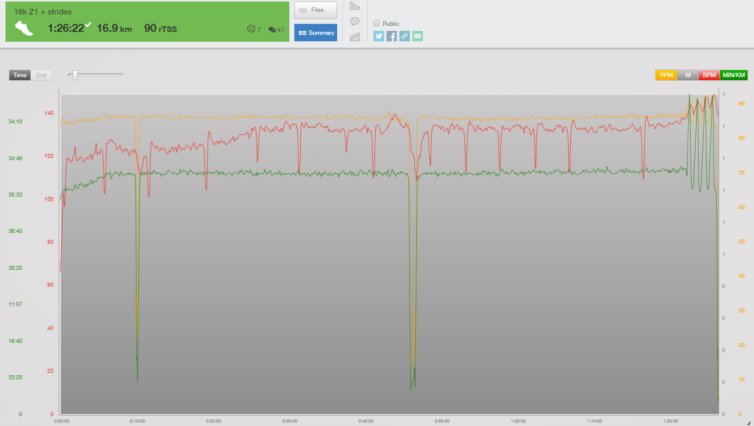

So… I haven’t been able to figure out if this is just the HR strap freaking out from time to time, or if there’s an underlying problem… I use the Garmin HRM-Tri currently, but it did the same when I was using the original strap that came with my old Ambit 2. I had a Mio at some point as well but I can’t pinpoint accurately a run where I used it.

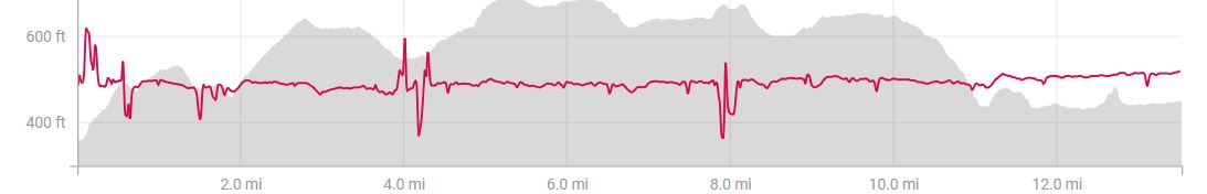

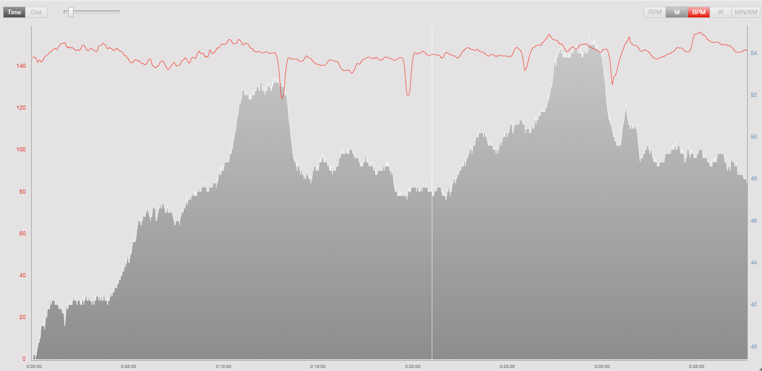

Are these HR dips normal (aka, just the strap doing something weird from time to time)? I always thought so, but someone recently asked me why my HR data was like that, theirs wasn’t… Happens in bike and run (I posted 2 runs, it’s easier to see on runs, especially on treadmill).
Looks strange. Hard to imagine a 20 bpm drop is real heading into some of those down hills. You stated that it happened with your old strap too. So it is probably environmental and not related to the garmin hrm tri device.

I had pretty much the exact same thing. Eventually I was able to correlate it with burping. Evidently, when I burp I get a slight vagal stimulation that causes the heart rate to drop a little. For me, it tended to happen about once per mile while running. I was able to see it when I was on the trainer. SO not sure if it happens with more than just a burp for me, but I do not tend to see it with coughing.
ing a Different scale, so mine do not appear as drastic. The bigger spikes are artifacts cause it was damn cold for this run.
I ended up getting a 24 hour holter test to rule out anything big (I wore it for a trainer ride and for a run).

You might be up to something with the discharges, although I run shirtless on the TM… I get shocked like a madman on the TM every time I touch the control panel… I’m not a super heavy sweater (though not a light sweater either). This treadmill run was Z1 though so I didn’t sweat much. I have to check if I get grounded, these disappear… might be tough on the TM but doable on the bike…
Strap is tight.

Just a follow up… This was it. Thanks, I would never have guessed that.
