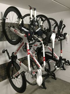

I live in an apartment. Looking to save space by hanging my bikes on the wall. Is it ok to use those wheel hooks? My worry is over time the wheels will come out of true much more quickly than normal.

We’ve hung mountain bikes, tri bikes, road bikes with no problems. One even had a zipp 60. Didn’t like hanging it on that, but we were told as long as it was structural carbon (not a carbon fairing) you’re good to go.
Don’t worry about it. The stress on your wheel hanging a 15-20 pound bike on a hook is much less than when you’re riding it and hit a bump or pothole.

It’s fine for every kind of wheel except for the carbon fairing. What’s the absolute worst that could happen? Wheel goes slightly out of true after a long long time of hanging like that? So have it trued.
It’s not going to go out of true from hanging by a hook! You have a 10x factor of safety minimum.

When you ride your bike, your weight is exerting a pulling force/tension on the upper half of each rim as the bottom spokes do not support weight. When you hang your bike by the wheels, the weight of the bike is compressing the rims at two localized spots. Totally different type of force (tension vs compression). Food for thought heh?
The rim is still in tension from all the spokes, so any weight/force applied as a point load gets distributed all around the rim. So it ends up being essentially the same as if the bike is resting upright on the floor/ground.
