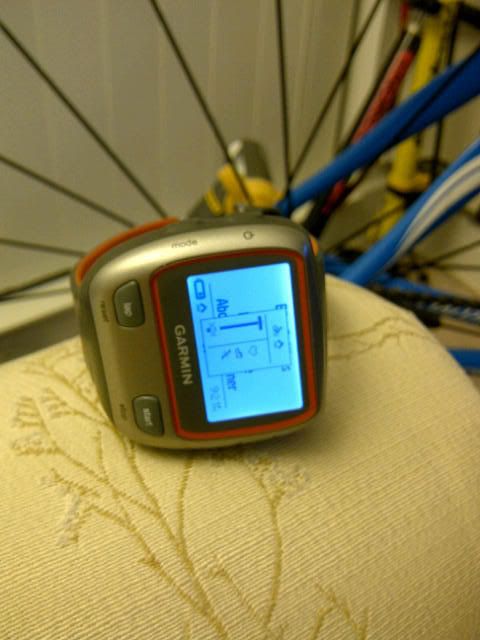

I’m using bike 1 mode. Gear with pedals icon appears on the watch. (see below - not a strike thru, but the pedals)

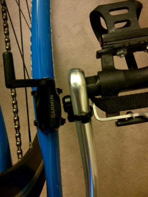

Attached is a pic of the setup.
http://i169.photobucket.com/albums/u206/wing_gundam/IMG-20111012-00016.jpg
Note - this is the same spot where I had just replaced my Cateye unit from.

  1. Try sliding the crank magnet a bit up or down the crank. I recall having troubles with this because, as I learned, it is not supposed to line up where it looks like it is supposed to line up.
  2. I also had to sandwich some tubing between my crank magnet and the crank in order to get it very close to the sensor.

make sure the lines on the GSC10 and the cadence magnet are lined up. I had this problem with my speed and moved the wheel magnet not even a full cm and it started read perfectly.

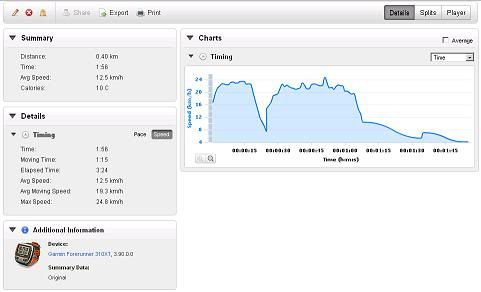

Here’s the garmin connect details of my test ride:
If Cadence were there it would appear below timing.
http://i169.photobucket.com/albums/u206/wing_gundam/test.jpg
Hey thanks guys - I got it working - moved it as close as possible without hitting the unit, did the reset, went around 60 times, then resync’d with the watch. Wasn’t working then remembered to press start :slight_smile:
