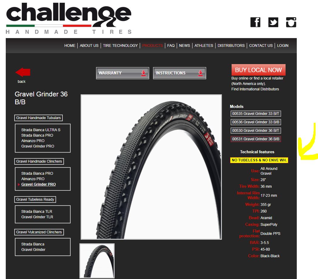

Are the sidewalls tan? (If tan, then Pro…if black, then indeterminate)
Did they lay flat when uninstalled? If yes, then Pro.
Also…are you sure they’re 36? Those are only available in Pros. The others are sized 38 and 42.
If they’re Pros, then you’re running them in a manner the maker specifically says NOT to do. You’re risking blow-off and/or burping…and then crashing as a result.

I agree they’re great…and with a latex tube inside of them, one isn’t going against the manufacturer warnings, and with no practical downside as opposed to running them tubeless IME.
But…it’s your skin and teeth you’re risking by running them tubeless…so who am I to judge?
