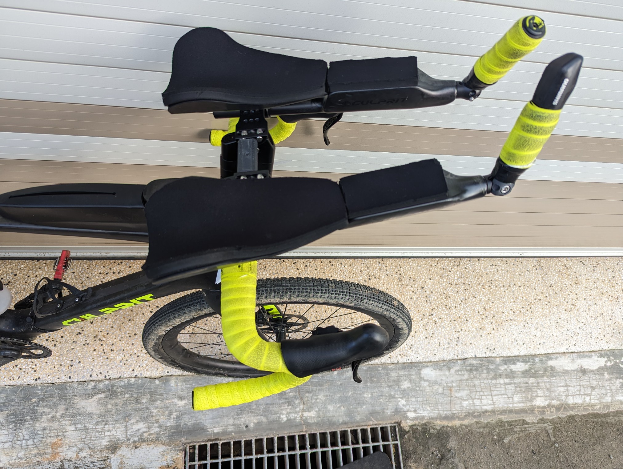

My new aerobars I tested recently on gravel and with the foam, design for full arm support it is incredibly comfy in chip seal, etc road,
Maybe a review in the future if I send it?
