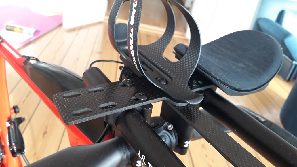

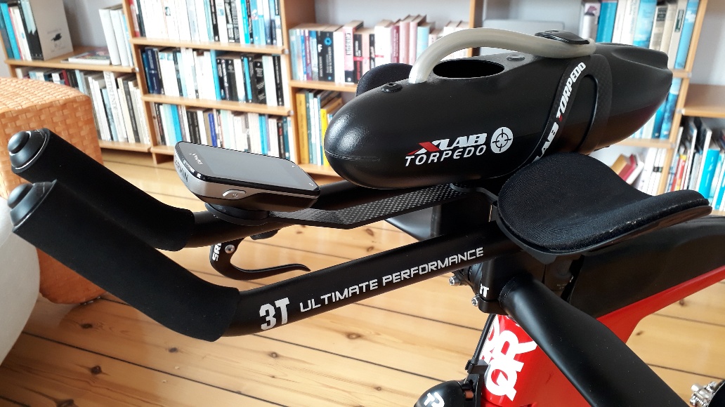

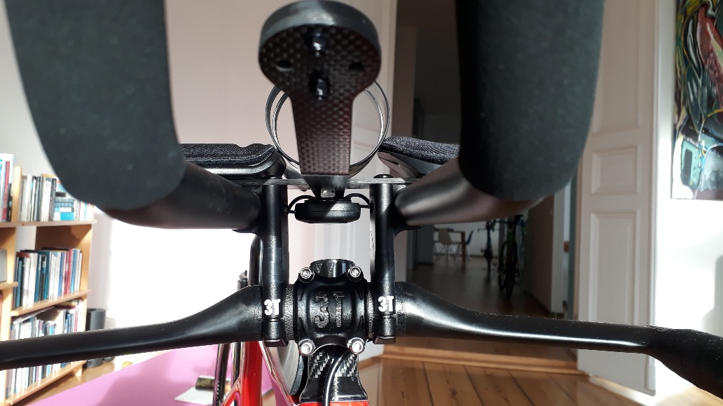

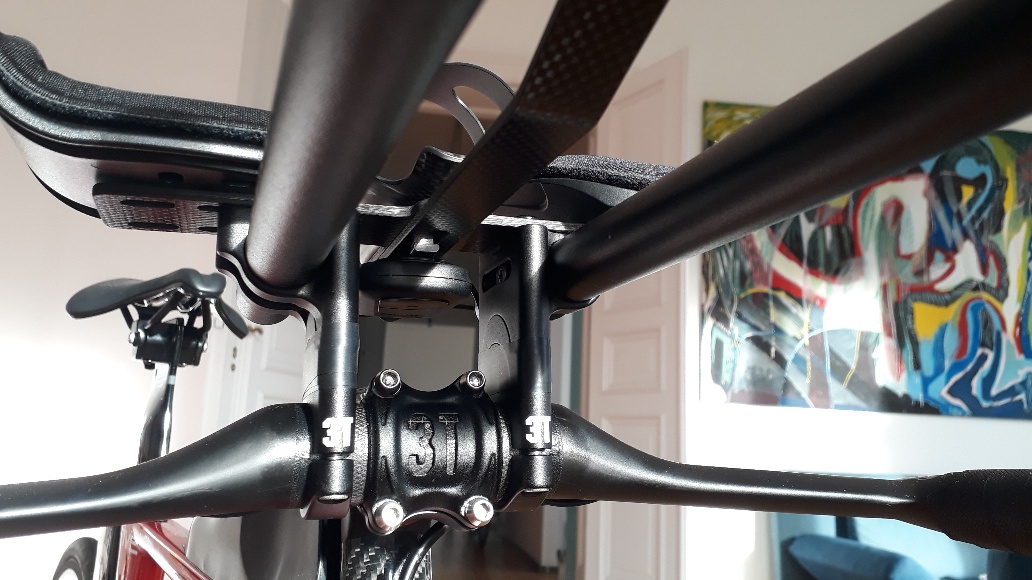

In case you are looking for customized carbon parts I cannot praise https://www.alden-carbon.com/ enough! They were reviewed recently by TriRig and I contacted Glen Alden on a custom BTA bridge for my 3T Clip-Ons. There is a bridge from 3T but that doesn´t allow a direct BTA/Bottle-cage mount and is also limited concerning fit. So the goal for the customized bridge was to have BTA/Cage mount and a hight flexibility at fit.
Glen came up with a bridge that uses slotted holes to vary Pad c-c and by turning around the bridge the bottle-cage can be moved forward/aft in a very wide range. We combined this with his extended computer mount (again with slotted holes for more flexibility) which overall makes a very sleek and versatile solution. This bridge is now in use on my wifes bike (BTA furthest aft) and mine (BTA forward). Thanks to the slotted holes we can also fit 3T or PD Armrests.
The bridge can be seen at: https://www.alden-carbon.com/bta-mount-systems?lightbox=dataItem-jnymu78g Pics of the setup on my wifes bikes are attached
Glen was a pleasure to work with and the end-result is a piece of art! He definitely knows his stuff, understands the requirements of riders and triathletes and his products are really first class.

what about the eTap blip box mount? Is that custom as well?

Thanks. The Blipbox has an M4 thread and I simply used an ordinary M4 screw through one of the many slotted holes :slight_smile:
Not sure if this is the final solution though. Once I find the nerve to cut the rear of the extensions I will try to mount the Blipbox sideways of the stem (hidden behind the bracket).
