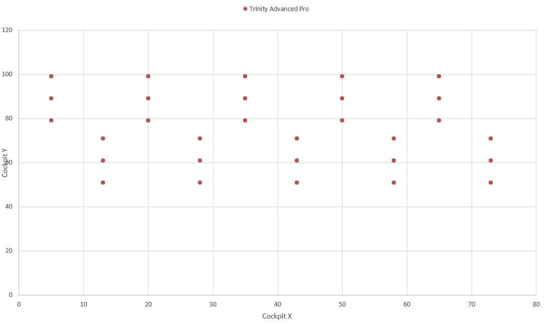

I am curious as to what makes it so hard to fit someone on the Giant. On my current bike (Kestrel Airfoil 56) my pad x is 520mm to the centre of the pad and pad y is 625 … I am 6ft tall and those numbers put me right in the mix for Slowman’s orthodox riding position. For a M sized Giant Trinity Advanced the pad Y range is 610-660 and pad X is 462-532 (not sure if this is to the centre of the pad or not) which seems to fit right in the orthodox range as well. They have 2 stems and ski bend bars now that seem to correct any of the old issues so the only issue I envision is that the bars don’t tilt. What am I missing?
That is all the XY positions that the 2018 Trinity Advanced Pro bars could hit. The lower set are for the TT stem, which in practicality is a completely different bike (unless you wish to buy a fork with your stem change). Frames sized such that there was no stack overlap - you’re a medium or a large - no grey zone.
For 2019 they have increased the stack options a bit, but it’s not clear if that is just a taller stem or taller stem with more pad spacer options. From the look of the Geo chart the pad spacers are the same and you get a 20mm difference in stack from the stem. Which is a painful way to do it as changing that stem is no joke - a better pad spacer system (that doesn’t let the aerobars wiggle) to get stack would have been a simpler solution.
So 2019 hasn’t really improved (based on available info). Still big steps in X, limited Y and limited Z. You can get more pad width options with a PD Boom armrest and more extension options are easy enough. It is a bar system that requires being creative to generate more position options.

By big steps in the x you mean 15mm as big steps so you can be off by roughly half that much in the horizontal fitting…does 7.5mm make that much difference in the fit. I figure I shift my arms fore and aft a lot more than that when I ride based on terrain. I would have thought the width or tilt would have been more of a concern.
