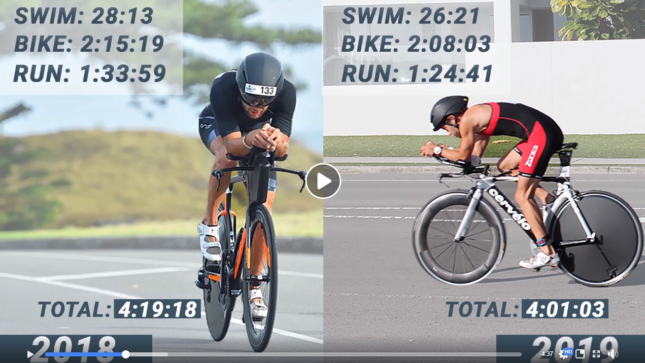

We did a video series about this last year with one of my staff
The point of it was not to pick on the Trinity. It was to show that position trumps anything else. So we spent ~$1100 USD to get George from decent AG result on the Di2 equipped Trinity to 5th in Elite on a 10yr old P3 with a variety of carefully chosen old parts.
If you buy only on the spec list the Trinity looks good.
But if you buy on speed
Ultegra doesn’t make you faster than 105
Unadjustable carbon bars will (for the majority) be slower than adjustable alloy ones
