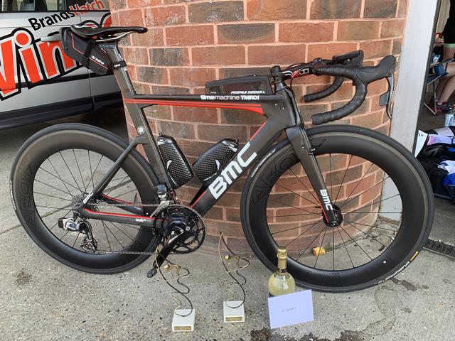

I actually did a 6hr road race recently (Revolve 24 - basically a massive crit around a motor circuit) and didn’t stop for nutrition, and there was no provision for handups. When we were in the tunnel I also put two Elite Crono bottles in the frame and a top tube box and managed to get a CdA of 0.2443m^2 in a breakaway road position with bibs and jersey (I had a skinsuit during the 6hr race), which was decent enough - if you need round bottles though I would definitely suggest hiding them behind you or between your arms. You can always put an aero bottle in the frame triangle filled with gels which is a nice way of having a few extra calories.
