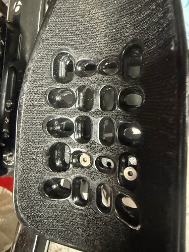

I was using similar to what you’re using hardware wise… my holes look a little different? Steeper taper, not much lip around the bottom… maybe a tad larger… I digress my left one popped off mid ride the other day mounted like yours pictured.
Here’s my current solution but not titanium/permanent… I am a heavy sweater so my cockpit needs to be corrasion resistant in addition to not falling apart.

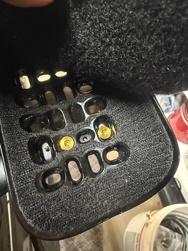

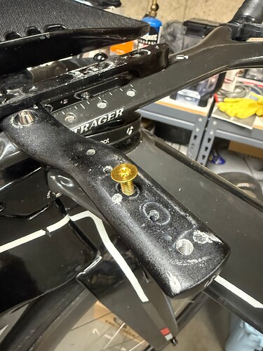

Huge thanks for that suggestion, I tapped out to M5 as the M5 tapered bolt head was in the 12mm range, which seemed perfect. Went with some Torx head titanium M5 x 12mm, seem to be the perfect length and size to be honest.
First pic is what I was using originally that wasn’t so great… m4 titanium, then the tapped m5… gold too, should be super fast!
Seriously, they should hold and with blue locktite not back out either… problem solved hopefully!
