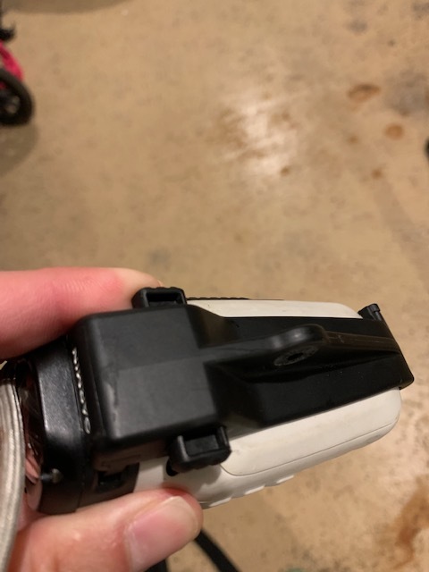

Yup. That would work. My Virbs both came with gopro adapters (pics attached).
Is that adapter in your pictures the eBay piece, or did it come elsewhere? Is it made by Garmin?

Yes, indeed. The old Virbs are cigar shaped and the new ones are rectangular. The new ones do not require the adapter.
My old virbs both came with the adapter. Check out this link: https://www.racycles.com/equipment/accessories/electronics/garmin-virb-action-camera-2353?sku=102718&gclid=CjwKCAjwwtTmBRBqEiwA-b6c_wv7e_PnYnk4X_IXboG5XredeNQ53Tv3PKRZHplHy-g8DFbEoDMWfBoC8HIQAvD_BwE
It says: “We even have an adapter to use VIRB with other industry mounts.”
They are talking about the adapter that goes between the old virb mount and the GoPro standard…seen in my pics above.
