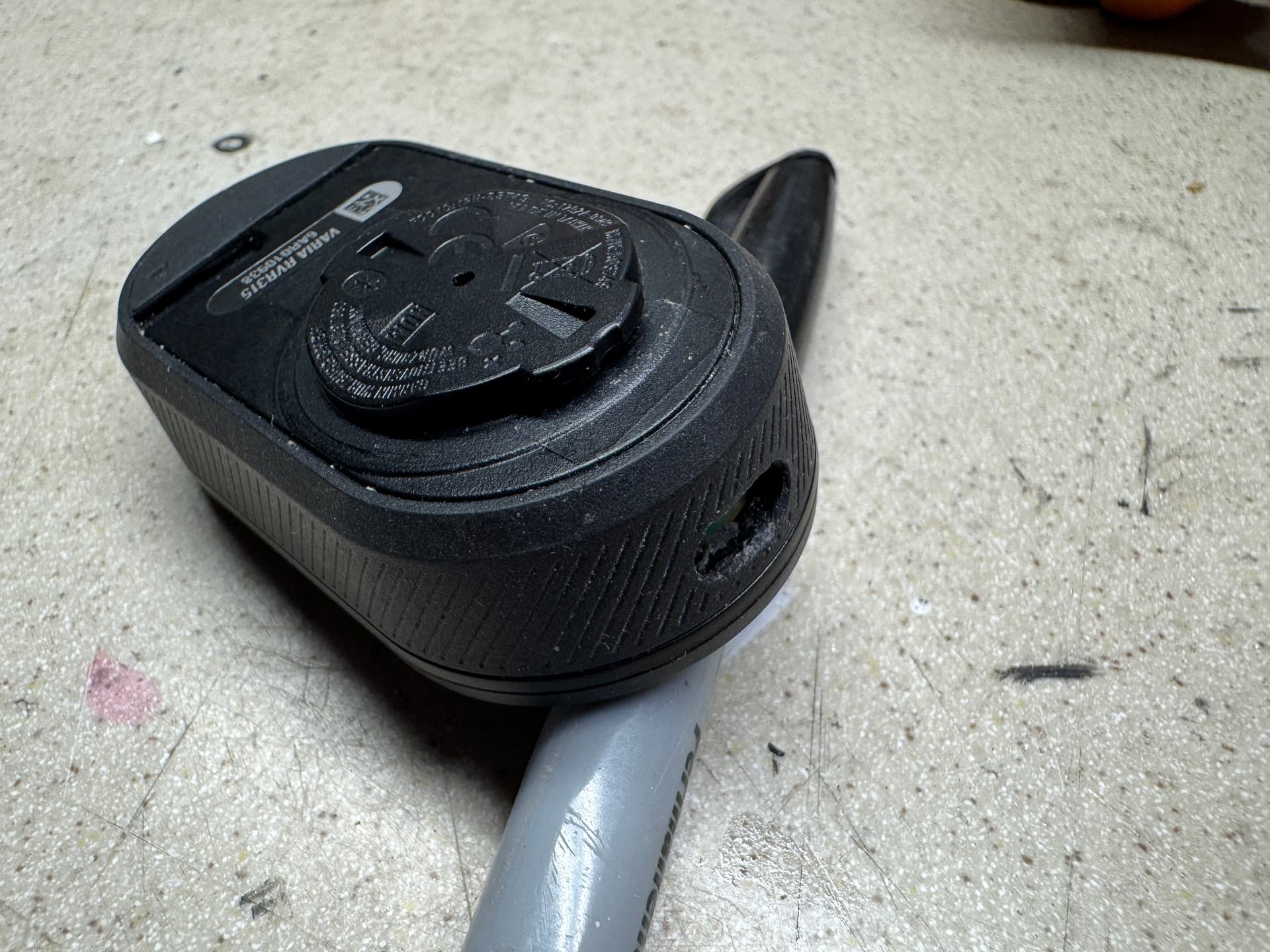

Garmin radar (RVR315) - anyone NOT have the top button disintegrate?
This is my second RVR315 where the rubber button at the top has deteriorated, eventually leaving a hole at the top. This seems like a design flaw to me but am curious if others are seeing this failure or if maybe it’s environment specific (hot, humid climate for me). I reached out to Garmin support and they offered a refurb unit for $80. I asked if there had been any update or change to the design and was told rather vaguely “the buttons have been fixed” but of course they can’t guarantee it won’t happen again. Anyone have experience with an updated button on the RVR315? Yes I do realize the RTL515 exists, but from what I’ve read its light is not very bright and I already have a nice niterider blinky that I prefer to use. Thanks in advance.

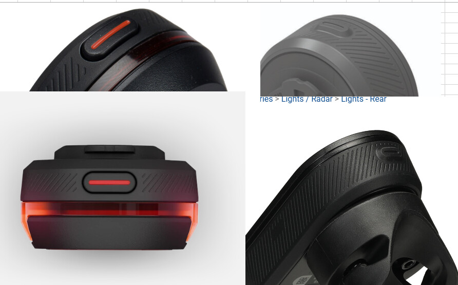

Online search of product pictures for both units frshows 2 things…
  1. definitely not the same power button on both units (lighted version on the left, dedicated radar on right):
  1. Also during the image search on google saw a lot of pictures of the RVR315 with broken power buttons.
Clearly a design issue of the RVR unit.
Yup, they’re very different. The version with the light has a gasket seal, the version without has an overmolded cover seal. Over time, the overmold breaks down. There’s probably a photodegradation or solvent exposure component to the breakdown, but it’s definitely an issue with these.

So I bought another RVR315 (used, but appeared with very little use)…..only to have the button fail again in very short time. Starting to wonder if I was just pressing it too hard, hah. But more seriously, am curious 1. how prevalent this issue is and 2. if it’s “worth” getting another one with the very vague statement from Garmin support of “the buttons have been fixed.”
Thanks for the feedback so far everyone - and if anyone thinks they have an updated version of the RVR315 (non-taillight) - please post a photo!
