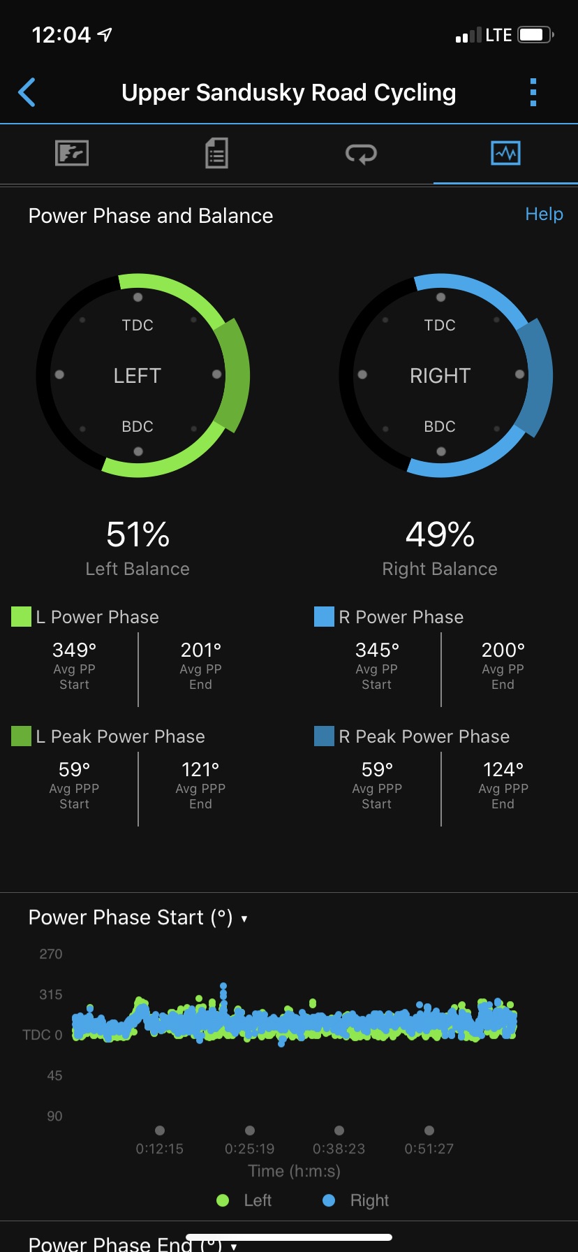

I have Assioma pedals and an Edge 530. Here is an image recorded this morning.
If you’re asking about live metrics while you’re cycling, the Garmin Edge 530 will display left/right balance as you pedal. Not sure about the power phase screen. And I think the answers might vary depending on the model of Garmin you’re using.
L/R balance, Power Phase, and peak power phase are captured. The one metric you wont get with Assiomas is the “Platform Offset”.
I have the Assioma and a Garmin 530. It displays L-R balance and power phase. DC Rainmaker has a photo of the display on his web site.
