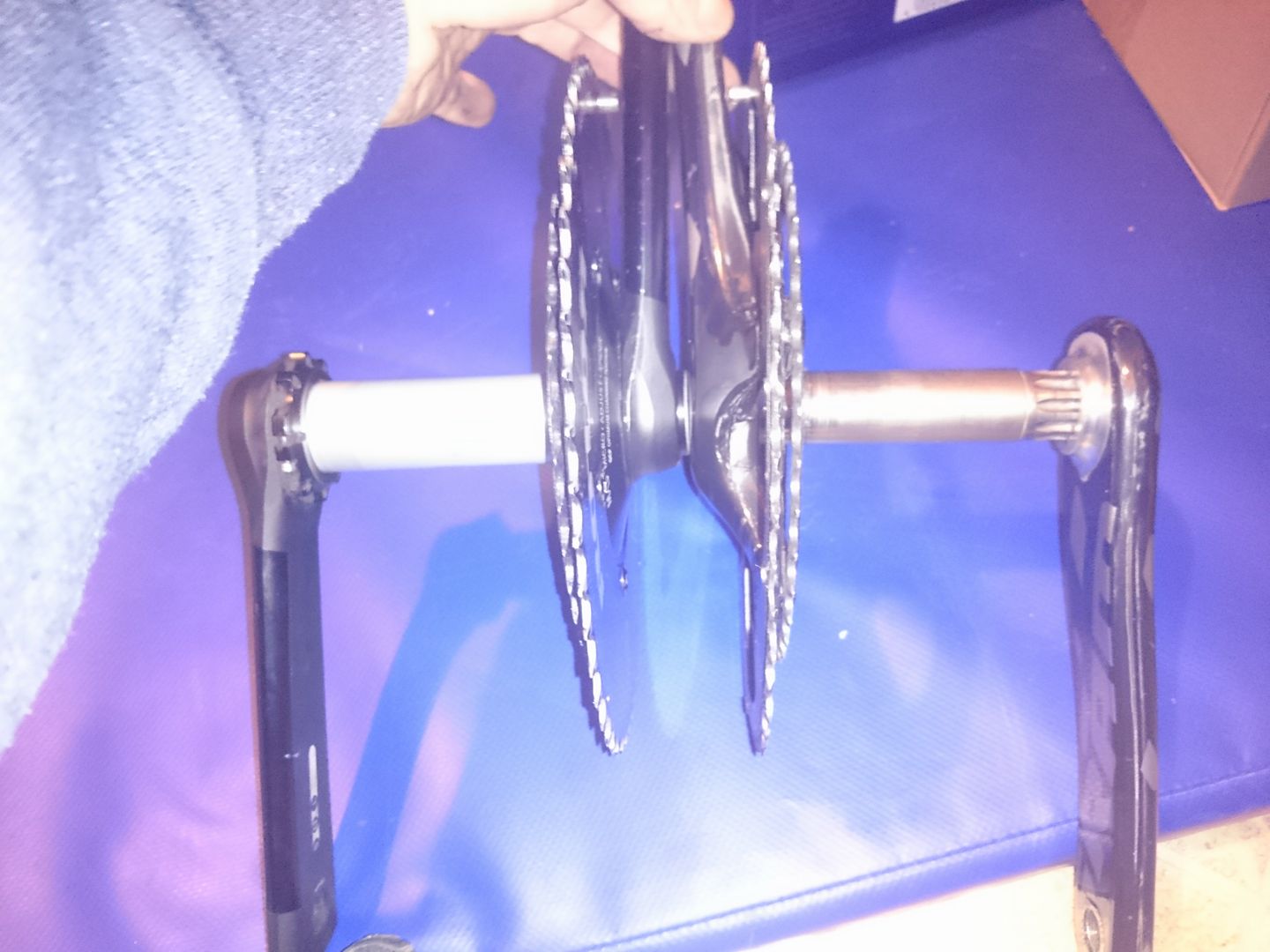

Experts,
I deeply hope that my Fuji problem -lack of power on high speeds coming from the crank…I would like to swap my crappy crankset (from oval 520) to one of these:
  • sram red 22 -172/53
  • rotor flow mas -170/crappy 52
  • ultegra fc-6800 -170/53. Should work with fd sram rival?
And bottom bracket bearings. Which brg’s you reccomend currently as the best for tri racing? (except ceramic brg’s). I’ve heard NTN brand has the best.
Which of these cranks (with bb brg’s) you suggest to apply?
Thank you for constructive feedback.

In all honesty, I don’t think you’ll get the expected return that you’re hoping from a new crank. Take the chain off and spin the crank, if there is no resistance from bearing binding you’re good to go. If the crank is too long/short that it is impacting your ability to ride in a proper position, get a new crank. If you want a power meter to train and get faster, get a new crank. If you are having significant binding from the BB bearings, get new bearings.
