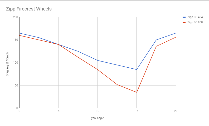

From Aeroweenie: https://docs.google.com/spreadsheets/d/1uiva924OLGSlO2Jwc0epr_0Oo-ArqiCsJT6YTM5UM4Y/edit#gid=0

I came across the chart but could use some help deciphering what it means. I’m not much of a physicist.
Assume I’m biking along at 21 mph (not 30, I wish!) on an out and back course like Santa Cruz. According to Best Bike Split my average yaw angle is 3 degrees. Looks like the difference is what, 5g? The curves don’t really seem to separate until 10-15 degrees of yaw. What does that translate into in real word conditions for a guy looking for a 2:35-2:45 bike split?
That chart is meant for ordinary cyclists, so you don’t need to be a physicist or a rocket scientist to decipher it. For example, at 15 degrees of yaw, the 808 FC has around 50 grams less drag than the 404 FC at 30 mph. Rule of thumb is 50 grams of drag at 30 mph is worth 5 watts. At 21 mph, 50 grams of drag is worth around 4.6 watts.
The equation is: 50 g of drag @ 30 mph = 0.5 s/km = 5 W = 0.005 m^2 CdA = 0.0005 Crr
So at 20 mph, you save 30 seconds over a 40K for 50 grams of drag reduction. Just learn how to handle your front Zipp 808. I’m 130 lbs, and I have zero issues doing a 40K TT using a front Zipp 808 FC, even in somewhat windy conditions.
