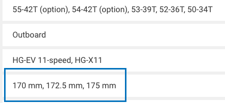

less good is that the crankarm lengths are 170mm, 172.5mm, 175mm. it would be nice of the crankarms came in shorter lengths.
FWIW, you can get the 9100P in 165mm.
thanks. my mistake. it could be that shimano just hasn’t updated it’s website or that i’m reading it wrong. this is what i see there as of this morning:
Perhaps they discontinued it for 2020, but they had availability in both warehouses last time I ordered one (early January).
Nothing shorter than 165 was ever available, to my knowledge.
