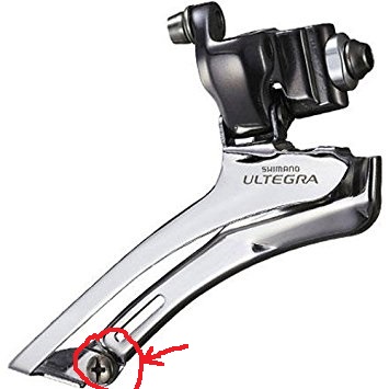

if cage width is the issue (you should test it first to make sure it is) you can just remove the bolt from the back side of the cage, add a spacer or two, and tighten up again.

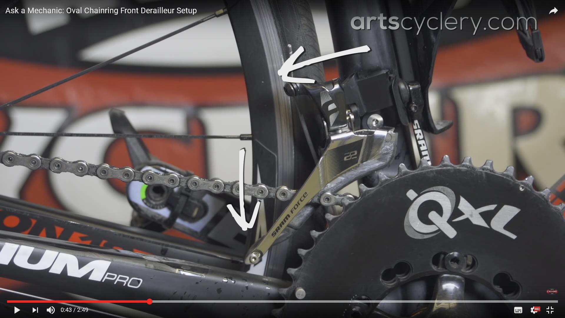

You can buy angled shims from rotor (and other sources) which will help with that problem.
I wrote a little bit about the install if that helps
I think the angled shim is just what I need, thanks for the heads up. The width of the cage is fine, the problem is the chain dropping on the back of the cage when in the big ring.
I sue the Rotor angled shim with their QXL rings. It tilts the cage down enough to clear the chain running on the cage bridge.
You may get away with one of the sram mtb front mech tapered wedges depending on how adjustable your front mech hanger is, but osym’s used to be supplied with a 10mm riser block, which also moved your mech back as well as higher.
Trainsharp and a few others sell a more expensive version.
I actually ended up having to use one of these with Q rings on my exocet as i couldn’t get enough clearance.
Morelock- i dont think you can open the newer shimano front mechs anymore; they’re either one piece or riveted.
sram wedgie:
http://2.bp.blogspot.com/-h6G7mn6K5a0/Vb4jMmBp3EI/AAAAAAAAL80/5xKyBXP9bvw/s1600/DSC_1810.JPG
Osym version:
http://tillquist.dk/wp-content/gallery/bmc-tm01/dsc05190.jpg

The main issue is the width of the cage. The ultegra and dura ace derailleurs I have - don’t have the screw anymore. They cage is riveted together. The only option I see is to buy a fd which has a little bit wider cage or perhaps go some other route?
Try a campag mech. They seem to be a bit wider, and also a little less flexy to me. Doesn’t have to be record, veloce is fine
That is a good tip. Worth trying I think. Do you know what exactly is the width on the cage for the record campy fd? I think that if I have 2-3 mm more width then ultegra\DA then that is all what I need.
Drill out the rivet and use the screw and washers (spacers) Osymetric supplies.
I’ve been running Osymetric’s for a year with a 105 derailleur on a P2. Whilst it’s viable I’m often having to trim the derailleur & even then there’s always noise under power in the 52x11.
I’d love to get this sorted, but I’d rather avoid drilling the derailleur. Reading around it seems that the QXL rings are less finicky.
