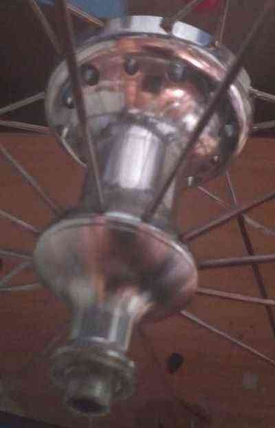

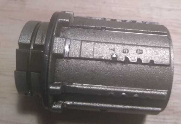

thank for the reply - the wheel is an old Gigantex wheel from Taiwan. There are no markings on the hub. The freehub has a small stamp of BG7 on it. There are 9 peaks and 9 valleys (splines?) on it and there are 3 sets of pawls. Hopefully these pictures will help, I’m not too good with editing.
thanks for any help!
There’s nothing wrong with your freehub body.
the reason I was checking is I’ve having skipping problems when shifting up and down in a couple gears and no adjustment has helped. The chain is ok, so I thought maybe the cassette was worn and I would swap to another. I couldn’t get some of the cogs off and had to force them backwards to get them out of the groove they’d dug into the freehub. I’ve seen wear on my other freehubs, but not this bad where I’ve had to force the cogs off. I was wondering if this misalignment was causing the shifting problem. I don’t mind replacing it while I’ve got it apart, but if I don’t need to spend the $$ that’s even better.
That’s pretty bad, but it probably isn’t causing the shifting symptoms you describe. That sounds like you need a new cassette. I’d try that first.
Before you put on a new cassette, use a fine tooth file to flatten the “bumps” on the outward face of the freehub body that were raised when the cassette imbedded itself in the freehub body. This will help a lot with installation/removal.
Every one of my aluminium free hubs across 4 bikes look like that. All work perfectly well.
All I do is file down the raised burrs just to make it easier to get the cassette back on again.
(As others say its a result of the steel individual rear rings digging in - whereas a cassette with a machines Alu carrier spreads the load over a far bigger area).
Slight PITA sometimes getting a cassette off again as the rear rings can dig back into the same dents - just have to use a mallet to get the freehub body out of the cassette).
Only one thst isn’t has a steel freehub. Some freehubs (some DT ???) have steel inserts in the edges of the splines to prevent it.
