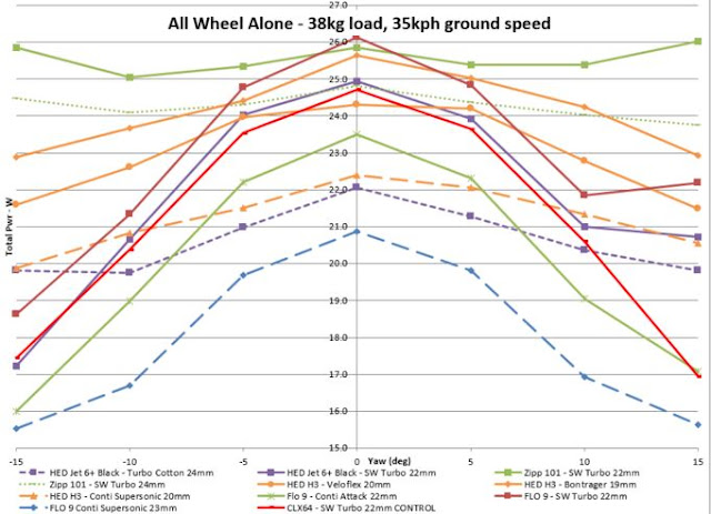

  1. HED jet 6 plus SW turbo 22mm vs FLO 9 SW turbo 22mm:
    Looks like HED a bit faster, i’m not sure about hed 6 vs flo 6, probably the same.
Source: TomA]
https://2.bp.blogspot.com/-2E27JytZwsc/Vty7OJwj7dI/AAAAAAAAAhk/yusyl8PXDdY/s640/All_Wheels_Total_Pwr_2.JPG
2.Also, I can be wrong, but looks like Wheel H - HED, Wheel F - FLO:
https://d2f0ora2gkri0g.cloudfront.net/0d/41/0d41144c-7d6e-43b5-80d7-00224ae769de.png
