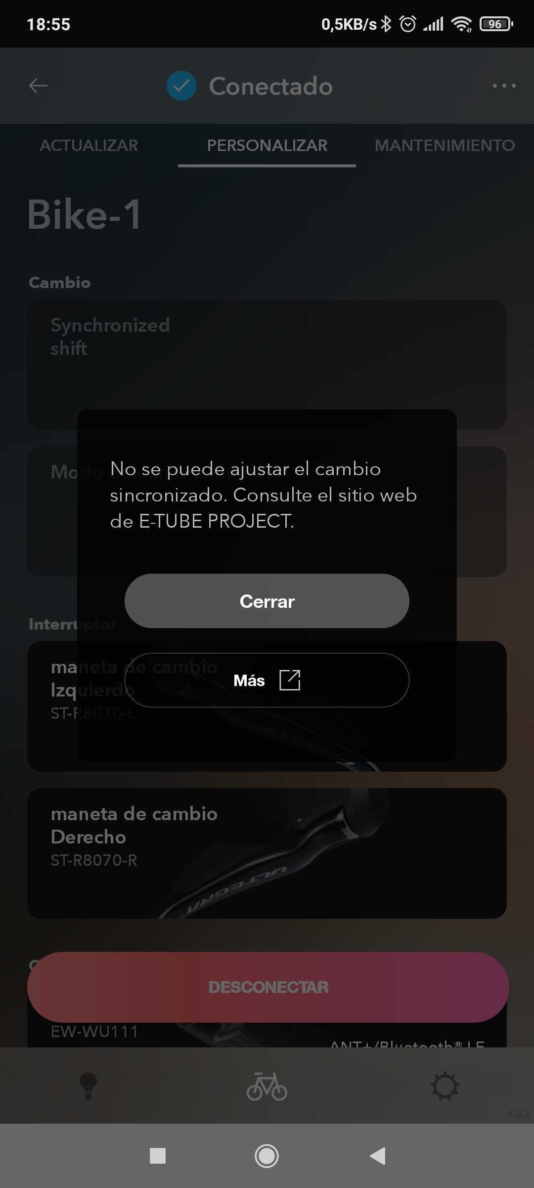

In my e-tube app, the right sift seems unsetable: (in Spanish, “cannot be adjusted”):

When you try to apply settings to the shifter, what values are you trying to set? On some bikes E-Tube attempts to use “Cyclecomputer Left/Right”, which isn’t a valid option (unless you have a Shimano “cycle computer” or E-Tube ride device paired). In order to change page on garmin/wahoo/etc you need to set it to channel 1/2.

When connecting it to the Etube, it says I cannot set the shifting, but doesn’t says why.
